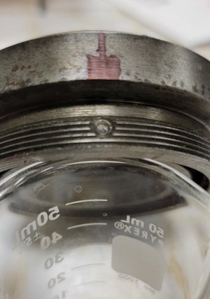

My nose cap DOES NOT HAVE a set screw AGAINST THE THREADS. The set screw has a particular spot on the nose cap threads that it is designed to fit into. It is a recessed pocket in the threads of the quill. Here is a photo.
For now, I have a sharpie mark on the nose cap so I know where the recess is so I can align it with the set screw on the quill. I will put a punch mark there after I decide which mill to keep.

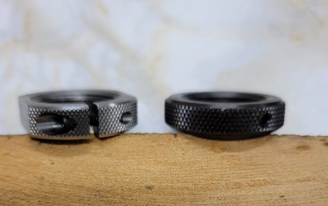

My favorite method is to use split rings where I can. These are basically a regular lock ring with a split in it. The split is then drilled side-to-side and then tapped for a small Allen screw which draws the split together tightening the lock ring in place.
Here is an example. The original lock ring on the right and the replacement on the left.
Of course you can't really do that with the nose cap. But I'm fine with the recessed pocket for the set screw.
For the Bridgeport: original from the factory the end cap was tightened on and then a recess drilled into the spindle (as you can see on the nose cap previously pictured). Depending on the age of the mill and the repairs made, there may be several “detents” drilled for the location of the set screw.
The nose cap should be snug and the set screw just needs to be in place to lock the thread but certainly not to mash it.
If you tighten the set screw “solid” on to the threads you will ever so slightly warp the spindle and it will work like crap in the last couple inches of travel.
In this application, as a lock, I see nothing wrong with the design or function. For my particular mill (I have the QC 30 design)there is no real stress or strain on the nose piece to cause concern even if the screw was not there.
Be careful using the original “detent” as a “tighten up to here” spot as it may or may not work out if you change bearings.

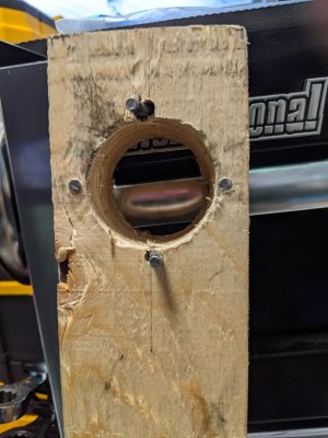

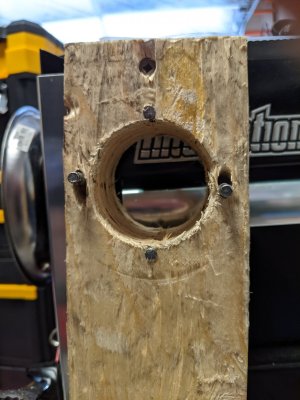

Was able to exert more force with the help of my friend standing on the house. But the nose cover has defeated the plywood-Excalibur... I have been stuck on this for too long and will just come back to in the future once it's all reassembled again.

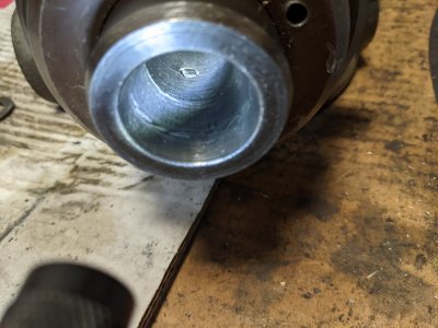

So what I want to ask is, does the set screw guide for the tool holder look sheared off? Or does it look like it’s backed out flush with the bore and pressing against the nose piece threads?
Sheared clean off - R8 collet must have spun - should still be able to get the nut off - just might need a bigger boat - er….tool … LOL.

Also, it's apparent to me that you need to make a steel tool on your lathe. A round collar to barely clear the spindle with drilled and tapped holes to take 1/4" grade 5 Bolts with the noses turned down to fit the spanner holes, and two 1/2" tapped holes on the sides to take regular 1/2" bolts that serve as handles would get the job done.
Perhaps easier would be a big nut chucked on the lathe and then bore the center out to clear the spindle nose. Then drill and tap for 1/4" grade 5 Bolts as above. The difference being the ability to put a big wench (pun intended) on it! Big nuts like that are available at most farm supply outlets.

The leverage isn't the issue. You can see that we've applied so much force that the plywood has failed. JamHandy will rig a metal tool together. And if THAT fails, then I'm taking the quill assembly to see Brent!
