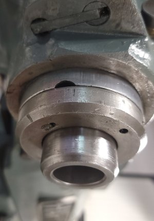

On my 935 there is this setscrew that engages the nose cap threads. That just rubs me the wrong way on many levels but I put mine in lightly with a drop of blue Loktite.
On my Bridgeport and my Hartford, there is a drilled recess in the threads so the set screw does not touch the threads.
That means that you have to be careful to align the cap and the quill so the set screw actually engages the recess and not the threads, but it's a piece of cake to do. You could simply add the recess. So the lock tight and the careful light torque are not needed.
My Hartford also has a groove in the end of the quill so that the two R8 set screws are more easily accessed. I plan to add the groove to my Bridgeport too.

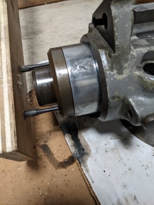

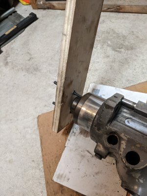

Inspired by @PeterT I did a quick/rough/awful version with some plywood. I have to keep one fit on the housing while I pull on the plywood. It would only move 10 degrees at a time. Manged to get it a 1/4 turn and started to slowly see a crack. I sprayed some WD40 in there and it's dripping out all dirty. I also notice after turning the nose that the spinning the spindle sleeve seems more rough, and making some scrapping noise. Not sure if it's the bearings or what? Hope I'm not ruining anything ... :oops:

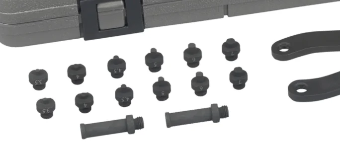

My wood isn't drilled precisely so the taps are skewing and burring the edge of the opening. So I think I will order some pin spanners. Any recommendations? I bought this one but realized the head is way too big:
I got the exact same one on Amazon. Pure junk. Arms are too fat and one was cocked sideways at 20 degrees or so. It was already in return mail when I read your note. I prolly won't buy another. I like the wooden design and if it ever fails me, I'll make my own steel version specific for the job. I did like the principle of the junk version though with a hinge and threaded in Pins so I may copy that design, but fix the quality.
I think your pins are simply too long. Cut a hole in the wood so it slips over the nose. That should stiffen it up.
@Susquatch yup I looked at the spanner for 5min after realizing it didn't fit and put it right back in the Amazon mailing box lol. It's going back this weekend.
Yeah I remove the set screw no problem but the nose is just really, really stuck. I don't intend to take apart the spindle. I just want to take the nose cap to clean it up and figure out where the groove is to properly line up the set screw again.
Yeah, I may just take my jig saw and rough out a hole to fit the spindle nose in. I'll drill smaller holes so the end of my pin punch fits snug.

Don't laugh at Mr. Woody, it worked haha. I had read where guys were having to grind the pin ends of those expanding spanner type wrenches to engage properly but this might be a function of the wrench model and/or 935 mill. Yes 2 set screws used for the collet guide, dog point & retention. The reason I was in there to begin with. You don't want it protruding too far in or it can jam up in the R8 slot.
Do you have dimensions of the the pin holes and spindle circle? I will attempt my own quick version of this.
@Susquatch Yeah I remove the set screw no problem but the nose is just really, really stuck. I don't intend to take apart the spindle. I just want to take the nose cap to clean it up and figure out where the groove is to properly line up the set screw again.

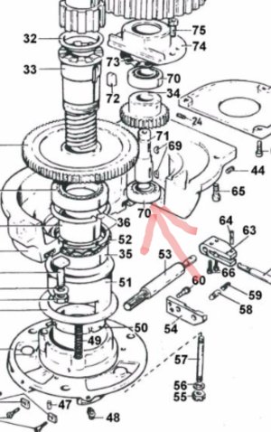

I dont like the idea of drilling the case. And like you, I have not found a suitable puller. So right now, I'm thinking I might have to make something. I'm thinking about making a shouldered sleeve on my lathe that will go into the bearing but stops at the shoulder. Then inside threading it for my slide hammer, then splitting it in half. You stick the two halves into the bearing so the shoulder is on the other side, then screw in the threaded rod of the slide hammer. The rod holds the halves tight against the bearing. A few whacks and it should come out. I can make collars to fit any bearing as long as they are open on the other side to take the shoulder.
Here you go. Handle is shortened to fit on paper. And no guarantee whatever spacing they used on a 935 matches a real BP. I thought maybe pin circle was 58mm but often times these machines are a mashup of imperial & metric dimensions. Or maybe the circle is 58mm and they missed by a little in which case, trust the physical measurement. Anyways I just printed this, glued it on the ply using manual mode center punch to insert close fitting pins & it worked out. Another good reason for wood is you don't feel so bad if it doesn't work out on first try. Good luck
Can you post a picture or point me to a post with the picture of what you’re trying to pull?

The ring is probably tight because the threads are a bit mashed as someone prior to you forgot to remove the second set screw…
@architect , The ring is probably tight because the threads are a bit mashed as someone prior to you forgot to remove the second set screw…
I thought there was only one sscrew in this case. But it does seem that two screws are used here and there randomly.
After thinking about it some more, my guess is that someone tightened the set screw on the threads instead of aligning the screw with the corresponding screw relief first. That would mash up the threads too.

Both are sort of like what I had come up with in the dark recesses of my mind, except mine would be a custom fit to a given bearing. And mine would be hundreds if times stronger because there are no arms to bend or deform.
All require that the bearing not sit flush in its recess such that the "hooks" can grab the back of the bearing.
I'm gunna wait until I have a replacement bearing in my hands that I can lay an eyeball on before I decide exactly what to try first.
The nice thing about my idea is that you can always cut the back collar off and use a couple of shims to create a compression fit instead. But I'm pretty confident that it will work especially after I saw these and had a good look at the way that those Posi-Lock pullers work.
