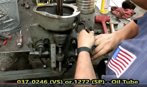

Is this not required then with sealed bearings?
Where does that oiler go on your mill? There is an oiler on my bull gear but it doesn't have a long snout like that. It seems like it only drips oil onto the teeth of the meshed gears and does not supply the bearing.
The H&W videos that I have watched recommend grease instead of oil. So if that is for the bull gear, they say you don't need it anymore.
Elsewhere I saw them say that using grease as per their procedure means oil is no longer required.
Others here have also advocated grease instead of oil.
I dunno. I'll prolly oil the spindle and just use grease for the bull gears.
But frankly, I'd keep in mind that I'm a newbie at all this if I were you. I don't have the experience that others do so I'm forced to choose what makes the most sense to me.
Choices are a good thing. Wise choices are an even better thing!
The HW Quill Housing Disassembly video talked about not needing this Oil Tube if going with sealed bearings. But after a rewatch I realized he's talking about the spindle bearings, which I will not touch, so the oil tube stays!
Mine is pretty grimmy. Any idea if I can just throw it in the parts washer instead of replacing? It's 44USD for this thing!
Try it. Before install - I would do a test to see if the wicking material still does it’s job. If you get drips forming and dropping off, I would call it good. If the material is still gummed up after cleaning, replace the wick and then test.
I would just clean it and reuse. It isn't a part that wears. Interesting that yours has a feed tube. My hartford is just a drill hole in the cover plate.
The video for the Hartford bull gear says to pack with grease and never oil again. Seems to me that Barry doesn't like oiling. Or maybe he knows most users don't oil often enough so grease is a better option for them.
I have trouble with that. But hey, what do I know.

I wouldn't remove any oil ports. Even with sealed spindle bearings you still need oil where the quill moves up-down in the head casting and on the splines where the quill moves up-down through the drive pulley hub.

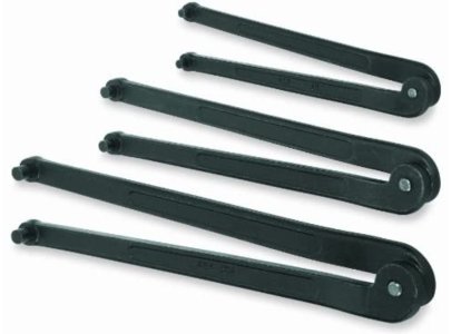

Hey @architect, I spotted these on Amazon and ordered a set.
JH Williams WS-483 3-Piece...
They are the same as the ones used in the H&W videos. Obviously, I don't need them for my spindle nose piece anymore, but I have needed a high quality set like these for years and they will be needed again in the future. Strike while the iron is hot.
I saw those and they are quite spendy! My neighbor helped me rig up a tool with a 1/4 plate I had. I haven't had a chance to use it as I need to first figure out how to pull the metal sleeves and slide the spindle back into the housing to get leverage. I don't think I need pin spanners other than the nosing. On the other hand, I'm still tempted to buy a Posi Lock puller in case I need one in the future. How did you gear bearings out?
Ya, they are spendy for sure. But I can use them on lots of jobs and I don't want to be making a custom spanner for every job I do. The spindle nose will probably come off a dozen times or more in order to replace the R8 key so I didn't mind making a unique tool especially for that.

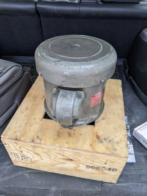

I've been away garage work for a while as I have been busy with work and gigs. Also hate the cold garage
But the border restrictions almost all gone Im finally able to cross over to Buffalo to grab this 240v motor for direct swap. Picked up new bearings and other parts from H&W as well. Prices went up 20% since looking at them 6 months ago
