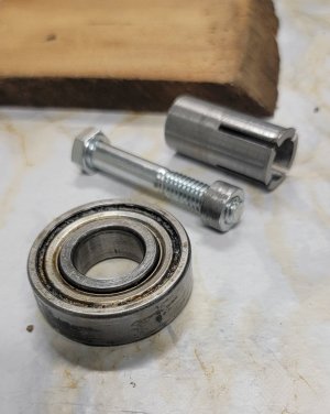

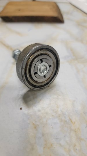

So I started making an inside collet today. Figured out a way to force a tight fit. The top side will be threaded to fit the slide hammer as discussed earlier. But I'm gunna drill out the bottom side of the collet a bit bigger than the slide hammer thread to allow the collet ears to bend a bit easier and also to take a tight fitting button. The button will be positioned at the top of the slits in the collet before the Collet is inserted. After that, the collet can be inserted into the bearing till the lips snap into place behind the bearing. The button is then pushed to the bottom to hold the collet ears solidly against the bearing ID and the lip behind the bearing. I'll drill and tap the button 1/4-28 so it can also be pulled back up to the root of the slots so the collet can be withdrawn if need be. I can't see how that could ever be needed, but easy to do and better safe than sorry.
My bottom bearing IS OUT!
Here are a few pics of the collet, button and bearing.

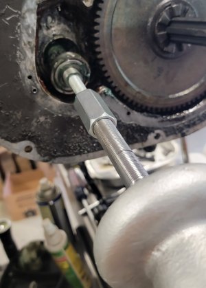

This shot shows it in the top bearing and if you look down inside, you can see the button ready to be pushed into place to expand the collet tight to the bearing.

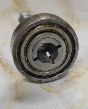

Here it is assembled in the top bearing. Button pushed into place

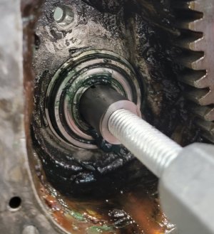

Here it is in the actual troublesome bottom bearing with the button pushed into place and my slide hammer screwed into the top of the collet.

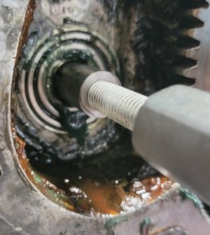

And here it is after a few FIRM taps on the slide hammer. It moved!
And here it is out! Woooo Hoooo
@architect - if you don't feel like making your own version PM me your address, and I'll loan you mine. It would probably work with a puller type assembly in place of the slide hammer, but there is something about shock loads...
There were a few improvements made as I made the collet. First off, I didn't thread the collet for the 5/8-18 of the slide hammer itself. That would have left too little metal behind and the collet might have come apart on a thread line. Instead, I threaded it for 3/8 and used an adapter that came with my slide hammer.
Second, I didn't thread the button for 1/4-20 either. Instead, I made it 5/16 because that allowed me to simply turn down a 5/16 nut to use as a button precluding the need for more threading. Besides, the bigger the nut, the easier it is to chuck it in the lathe.
Third, it turned out to be quite difficult to insert the collet in the bearing. Those ears just were not very springy. So I made the nose a tiny bit smaller by adding an end ramp and then tapped it into place with a small hammer using the 3/8 slide hammer adapter as a guide.
But all in all it worked Great. It's out. Now I just have to wait for parts.

And yes, it was a VERY tight fit. It took a fairly stiff whack on my slide hammer to move it. Even then, at first it only moved 25 thou or so per blow.

Actually, looking at the picture of the top bearing, it seems to be a SKF 6203, Made in Italy. If the bottom one is the same, I would call them decent quality bearings.
I'm really impressed that you could read that in the photos. I had to put the bearing under a lighted magnifying glass to see anything at all. In fact, the first time I looked, I DIDN'T see anything. I had to look twice. But yes, you are correct, they are "SKF 6203-Z ITALY" bearings.
