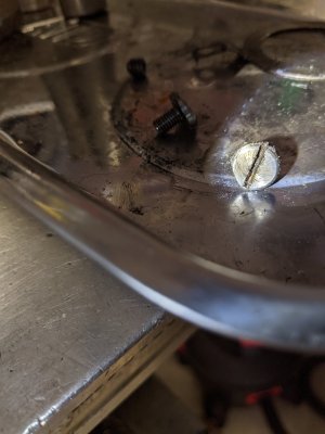

My nose cap DOES NOT HAVE a set screw AGAINST THE THREADS. The set screw has a particular spot on the nose cap threads that it is designed to fit into. It is a recessed pocket in the threads of the quill. Here is a photo.
For now, I have a sharpie mark on the nose cap so I know where the recess is so I can align it with the set screw on the quill. I will put a punch mark there after I decide which mill to keep.
I totally agree with your concern though. It bothers the daylights out of me to tighten any lock screw against any threads too. And no offense intended, but I don't like the lead ball approach either.

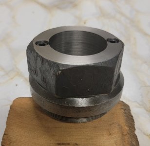

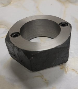

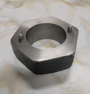

Kinda late to the party here but thought I'd show a couple pictures of a tool I made to get my spindle nose off - maybe it'll help someone next time. Just a little different pin wrench - gotta make it before you take the mill apart (or on your spare mill). Thick enough to get a big pipe wrench on. SHCScrews spaced appropriately and turned down to correct dia. Trap the tool between the quill nose and your vise or the table - insert a couple business cards under so you don't scar vise or table. Remove horizontal set screw as well as the grub screw. Mine was right hand thread (chinese clone) others could be left so don't get too angry with it too soon. Now you've got something trapped in there that won't slip and you can really get some force on it without damaging anything. Save it for next time ! View attachment 16068View attachment 16069
Very slick, thanks
Same principal as my bored out nut except you intend it to be used with a pipe wrench and I intend to use mine with a socket or open end wrench.
Finished my version of the nose cap removal tool inspired by @architect. Cap came off like butter off a knife. Very happy.
Easy to use with a open end wrench or a decent size monkey wrench. As a farmer, I also have sockets that big.
I say finished, but when I'm done all my priority work, I'll clean up the nut by facing off all the sides and bevel the end so it looks as pretty as it works.

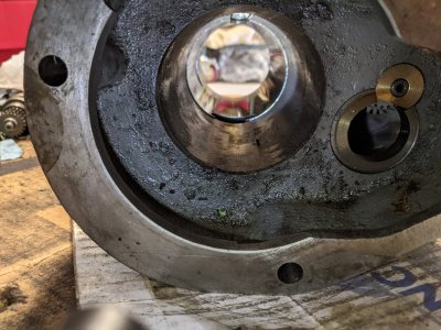

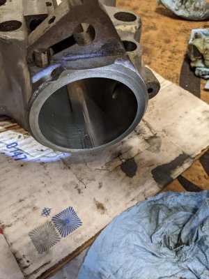

So I'm trying to get the quill assembly back into the housing but it seems to be really stuck, and caught on the skirt. Any thoughts how to make this work? Everyone's videos seem to make it easy and just require few skirts of WD 40.
I didn't remove the top screws holding down the filter before sliding the skirt out. Not sure if that may have caused any issues. The screws appeared to been filed down to provide clearance. Is this factory or did the previous owner do this themselves?
Did you check for burrs on both the quill cartridge and the housing bore? Remove any and all of them.
These parts are very close tolerance and will bind if the alignment is off even the slightest. You need to be very gentle to get the quill started co-axially in the bore. Use a light hand tap to align. It is easy to over-shoot center and end up stuck on the other side. In this video, he shows how he lightly hand taps the quill to get it started. If you could mount the head to something solid, it would help a lot.
I would remove the felt and only put it in after the skirt. He does mention that you could get things hung up on it.
The skirt goes in after the quill is installed.

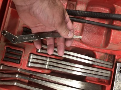

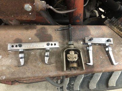

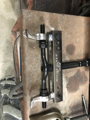

Any of those work for you? Or give you any ideas? The middle one in the first pic, as you screw down with the top handle, shoves the jaws further apart. Then you use a wrench on the nut to pull the bushing/bearing out
View attachment 16148View attachment 16149View attachment 16150Any of those work for you? Or give you any ideas? The middle one in the first pic, as you screw down with the top handle, shoves the jaws further apart. Then you use a wrench on the nut to pull the bushing/bearing out
All somewhat similar to what I planned to try and make. But they are all way too big. The center of the bearing is only 0.698".
I don't have a drawing yet but basically, I planned to make an expanding collet - just one split or maybe four. (I HATE SPLITTING.) The main collet body would be 0.7 OD but there would be a tiny "claw" at the very end (maybe 0.74) that would grab the bearing from the back. There is virtually no room behind the bearing for anything substantial. You push the collet through and it "snaps" into place. The inside of the collet is threaded to take the 5/8-18 of the threaded rod on my slide hammer. Since I will be making the collet, I will prolly make the inside thread a tight fit so the threaded rod acts to expand the collet for a VERY tight fit to hold the rear hook in place. Ideally, I'd like to incorporate some kind of expansion system to force a friction fit of the entire collet if the hook doesn't work. I just don't know how to do that just yet. I'm guessing it will take me a few days to make it. But my parts are not here yet from H&W so I have some time.
