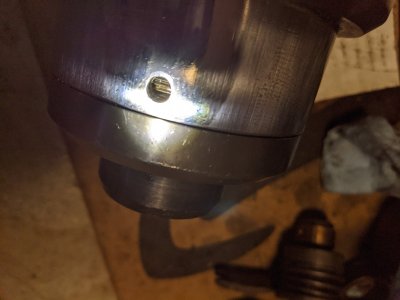

I thought there was only one screw holding the nose cover? o_O
I "believe" (from reading lots about the R8 alignment pin) that there is "usually" only one screw for the cap. And "usually" two for the R8 alignment pin. That's certainly how both my mills are.
However, I seen plenty of posts articles and videos that all say that the number of set screws on the Bridgeport mill and its Clones from one end to the other cannot be taken for granted. I believe the rule is to always check.
But I'll bet your issue is a screw that got tightened onto threads instead of the recessed hole and that buggered up the threads.

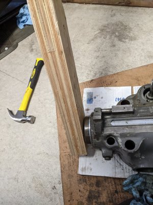

My generous friend mocked up serious plywood tool for me based on @PeterT design. It's working but still only bit by bit and even standing and putting my own weight on the housing can't get it to turn. Given, I'm a small dude, but still. This thing is really, really stuck. Need the bigger friend to come over and stand on housing...

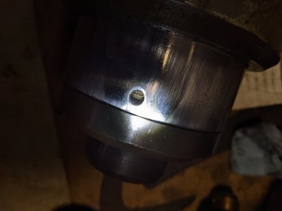

I'm wondering if the inner set screw wasn't actually put in properly and catching on the nose cover? I wonder how they even managed to get the cover on at all...
Peaked into the nose cap set screw hole and threads don't look so bad but hard to say. Sprayed some WD40 just for the heck of it.

Ya, it's possible that the 2nd R8 set screw has backed off enough to contact the threading. If so, I think you just have to grunt it off and risk buggering up more threads. No other way I can see. You can always buy a new nose piece.
But I'm still sticking to the theory that the primary set screw for the nose itself has buggered up the threads cuz it was not installed into the thread recess. This is actually worse cuz it's the quill threads that will be buggered.
Very nice looking tool. If you have a small gap, try some penetrating oil.
If all else fails, try lightly heating the nose cap. No need for Acetylene, a regular Propane torch will prolly do it. You just want to expand the nose cap a bit.
Also you could try back N forth like working a tap.
If my theory is correct, the threads will only be messed up where the lock screw was.

Are you sure you're turning it the right direction? Have you tried the opposite direction?
No insult intended...
Remount the housing on the machine, then you won't need your friend to stand on it.
Also, can you bolt the assembly back onto the head temporarily? That might give you the leverage you need.

Looking at the thread through the hole it looks to me like a normal righty tightly thread. :p
I believe I have the right direction and looks like right handed thread :) I can see it opening up with a little gap now! Doesn't take a lot of strength just awkward at this point. I need to really hold down the housing while another arm reaches at the end of the 4ft plywood and lever it it.
Yes, mounting it back on the housing makes sense. But I'm also short and don't have much room so putting it up higher causes other clearance issues!
If all else fails, I'd also try drilling a hole into the side of the cap. Not all the way through but enough to be able to use a pin spanner wrench that you can whack at with a small hammer. A home made version using your lathe could even wrap all the way around the cap, have two holes and two pins installed after the cap wrench is on. That would give you way better control than an end wrench could ever have no matter what its made of.
Hmmmmm..... I like that idea so much that I might modify my own nose cap that way and make a wrench like that for myself! Heck, if I drill the tool for the pin while it's mounted to the cap, I can drill right into the cap at the same time and not worry about pin alignment. Two Bolts for handles on the tool would give you plenty of leverage and something to tap on too.
