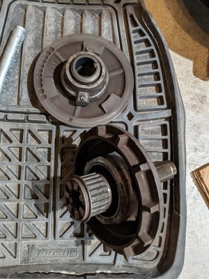

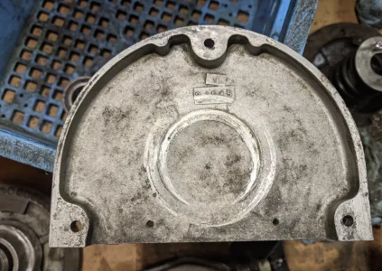

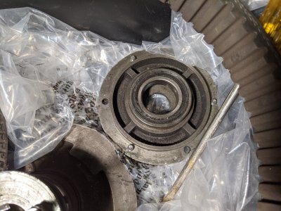

So the top bearing is really stuck to the cover. But I see the wave washer between there.

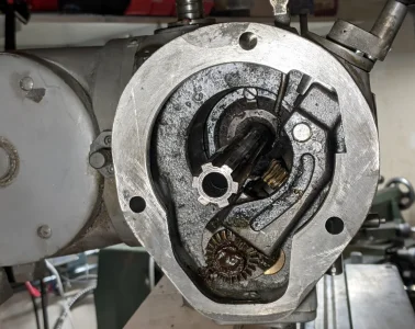

There's some play in the overall vari spindle assembly when it's in the brake shoe but can't quite figure out why yet.
The two bearings on the spindle are no good needs replacement.
If the bearing is toast - don’t be shy to destroy it to get it out. You want to protect the cover from damage, therefore you sacrifice the bearing that is broken already.
Not exactly sure what you were expecting: the brake shoes do not locate the vari-drive. The bearings of the vari-drive do. Are you saying the bearings (bushings) are worn? The bushings are considered a consumable and need replacing from time to time. Kits are available.
With all the bearings and bushings in bad shape, you might want to consider a BP head rebuild kit. It should include all the parts you need for the top half & spindle cartridge bearings are also available (not affiliated).

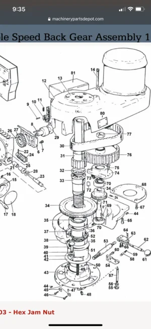

Could you please take a photo of the pages that deal with the back gear assembly? The rear pulley on my Hartford wobbles way more than I think it should and I'd like to get in there and see why it's doing that. But I'm reluctant to just start unbolting things......
Yes, I know that the book you have is for the BP vari-speed. But I'd bet good money that the back gear is the same on the 8spd pulley version too.

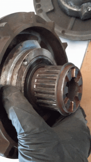

I found the play in the vari assembly... it appears to be missing the spindle spacer. This is probably what destroyed the bearings over time...

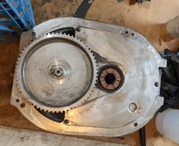

Missing in that video is any reference to how much play is allowable in the big gear.
Unless I missed it, there is only one bearing in there so some play is going to be inevitable.
My big gear has around 1/4" that it can be moved back and forth or side to side.
How much play do you think is ok?
The heads for the pulley drive and the variable drive are quite different; The variable has a Hi-Lo selector that maintains spindle direction, where the pulley uses a back gear that reverses direction. So very different mechanisms.
OK, so is the play I have ok on the JHead design or should I rebuild the back gear?
I have no play in any of the gears in my 'First' mill head. I have not disassembled my Hartford head.

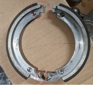

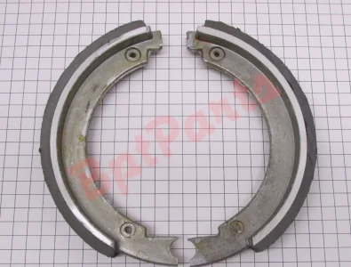

My brake shoes look asymmetrical but hard to say if something broke off. Maybe best to replace.

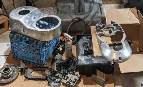

Motor pulley cover has scars from the motor spring. Is this a cause for concern?

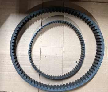

Belts look clean
Spindle pulley spins decent with no kinks. It doesn't fly with freely with it's own momentum but maybe that's normal?
Now I'm just waiting for my Princess Auto gear puller to come in to pull the bearings from the vari-disc assembly and continue into the back gear housing
I've just been cleaning all the parts until the puller comes in. May get a cheap small 2L parts washer to get all the bits nice and clean.

I don't know anything about mill brakes. But I know car brakes quite well. If they work the same, it shouldn't matter if they are a bit asymmetrical. Unlike disc brakes, drum brakes in a vehicle don't touch the drum until applied and they self center. The shoes also look fairly evenly worn. If rotating the actuator applies them evenly, with lots of room for wear, I would guess they are ok.
A little wear on the lining, but nothing to worry about or warrant replacing. File off any sharp edges and raised burrs in the areas you circled. Check for hairline cracks. If a-ok, install. You’ll never wear those brake shoes out - they lasted this long.
I would investigate that one a bit. See what could be rubbing - a key that has slipped out a bit; a bolt that is not tightened all the way. Maybe the pulley sheave slipped down on the motor shaft? Once the motor with vari-drive is back in the head, check clearance. There should be some.
