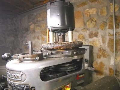

This is a bit different, but seems to work...
http://www.chaski.org/homemachinist/viewtopic.php?t=84079
Wow...... I'm impressed at the sheer ingenuity and the willingness to even try such a small motor.
But what really caught my eye is that stone wall!
I visited the link and I learned something new that the rest of you already knew. I feel kind of stupid, and it might be obvious to everyone else, but never underestimate what a green horn doesn't know. That reminds me of another great saying I love - "You don't know what you don't know".
Anyway, I have been busy looking for two speed motors and can't seem to find them. Yet both of my mills have a hi and low speed switch on the motor. So obviously, they are two speed....... Apparently NOT!
It turns out that the switch is actually a forward/reverse switch and it is used in coordination with the back gear! I would never have guessed that on my own!

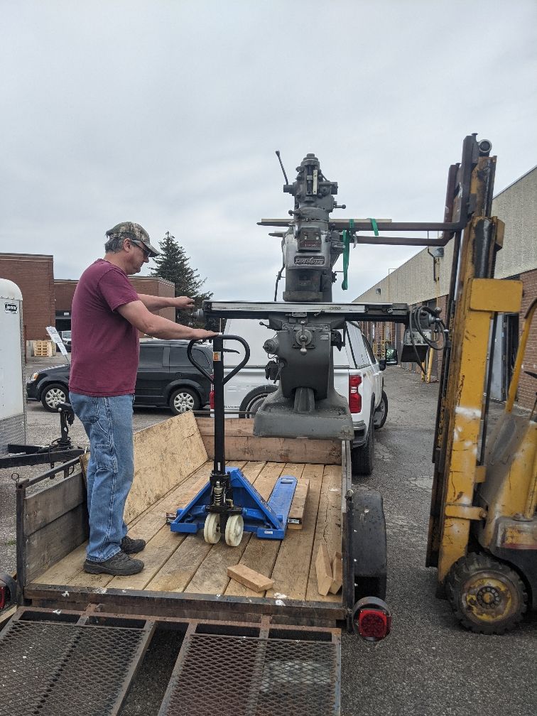

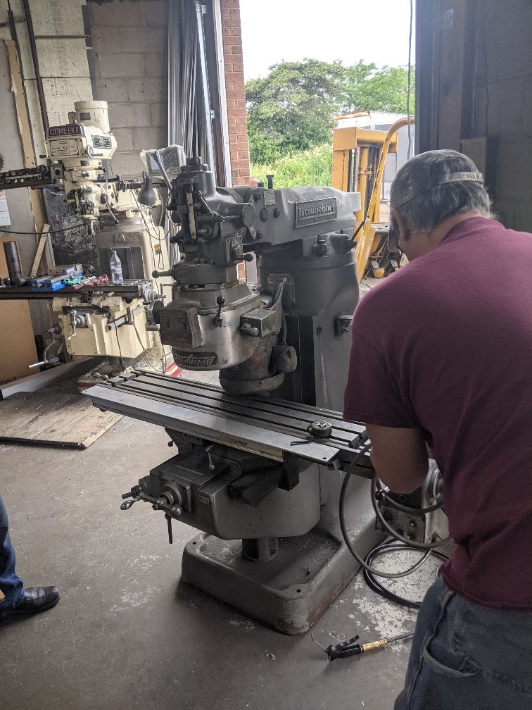

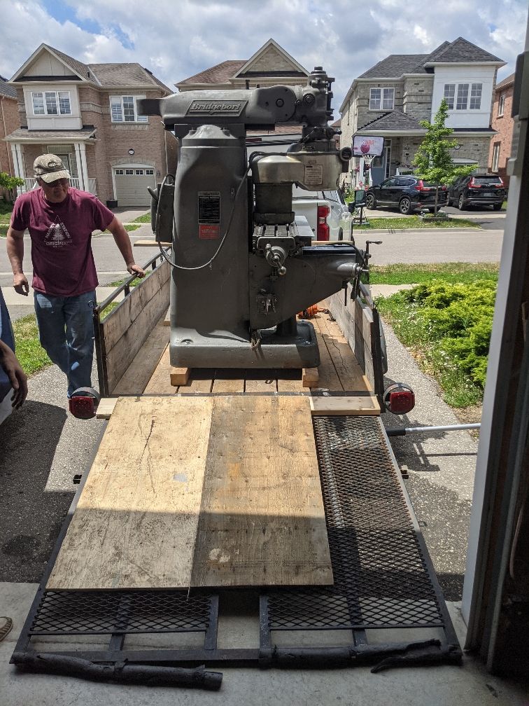

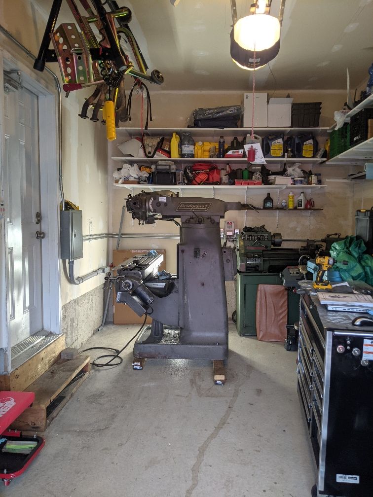

Took about 4 hours but @Brent H is a genius and three of us muscled the Bridgeport nto the back of my tiny garage. I'll need to spin it around 275 degrees but saving that for another day as I'm exhausted and need to make up for skipping work today!
Some dicey moments that couldn't be captured. Photos show all the good moments where I'm able to stop and take a photo. Brent had a wench tied up to the back of trailer to slowly release the mill down the ramp. I'm not going to pretend I wasn't nervous lol I'm sure Brent was fine with all his experience.
Was it rolling on something?
