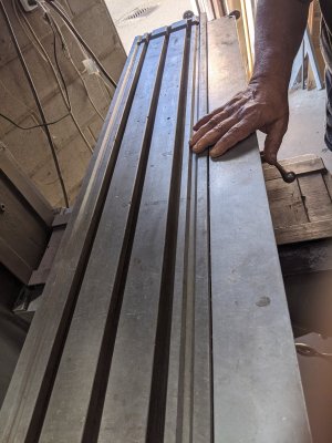

Bridgeport Project
Bed isn't pristine but good enough for me!
At the end of the day it won't be able to run after bearing replacement until I located a 220v motor.
Me too. Keep me/us posted on your motor search. I'll do the same. Hopefully one of us can find a supply so we both win.
Never thought I would ever be so impatient. I can't wait to get at least one of mine working......
What are you looking for in a 220V motor? 1ph or 3phase? Hp?
What is in there now?
Are you considering a VFD?

For sure.....and you get a mill with new bearings. Is that a standard NEMA frame or something special? It might be worth comparing the the cost/bother of new motor or rewind option to to single phase step up transformer + a VFD. I did it on a smaller 440V lathe...worked really well and there usually seem to be some used single phase transformers kicking around on kijiji. Not saying its neccesarily the way to go, but worth consideration as an option.
Can this be done the other way around? 220-1ph power to a 220 VFD to 220/440 transformer to 440-3ph motor? I know the VFD's like to feel the motor current flow to adjust their output, but I wonder if they can be bullied into just doing what they are told.
Wondering about it because I've seen lots of three phase 440 or 550 to 230 step-down transformers around. I think they should work fine stepping the voltage up too. But I know precious little about VFD's so I have no idea if that part would work. I have a call in to TECO about the standard application. Maybe I'll ask them about this too.

Here's the problem in using a transformer between the VFD and the motor: The VFD senses instantaneous current and back EMF to run the motor in Sensorless Vector mode, which is preferred on a milling machine. SV mode allows the motor to develop better torque at slow speeds by doing these measurements.
The downside of SV mode is that even leads to the motor longer than 2m can seriously affect the sensing required to do the job.
So putting a transformer between the motor and the VFD will completely screw up the SV mode. Check with the TECO/Westinghous folks, but I'm pretty sure that they will tell you the same story.
