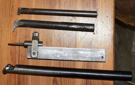

I've had to grind the heads of some boring bars as well, with small boring bars it's de rigueur. You can also raise the bar, but then rotate it so that the tip of the insert is on center. This also gives you added clearance below the tip.Most boring bars have a minimum ID Dimension for holes they can bore. And yes, some inserts increase that minimum dimension.
I have often ground away the bottom of a bar to get the required clearance. For a home ground bar it's no big deal. But it hurts a bit when you paid good money for the the bar.
Thanks, Dabbler. I have a duplicate set of drills just for brass (and aluminum, too as it can be as 'grabby' as brass) that I've slightly modified - they definitely do work better. I was surprised how much better the 'for aluminum' inserts worked on bronze and brass than what I'd been using, and they do stay sharp. But I'll try your suggestions.@VicHobbyGuy When I machine soft materials that can gaul, such as soft brass or some bronzes, I modify the twist drill or lathe tool to provide neutral rake.
Well, it was good money, but very little of it. Probably $10 from AliExpress. I ground away as much as I dared, then decided to switch to a home ground HSS boring bar made from a 6mm (?) HSS round blank (also from AliExpress). And, no, I'm not posting a pic of that one-it's really crude but it got the job done with a lot of light passes.I have often ground away the bottom of a bar to get the required clearance. For a home ground bar it's no big deal. But it hurts a bit when you paid good money for the the bar.

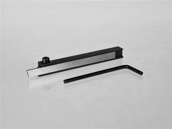

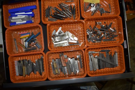

Do you have a collection of HSS tools as well? I'm a complete beginner, but I wouldn't want to give up my A.R. Warner HSS parting blade (.040" ?). My insert parting tool can't reach very far into a workpiece, and it's wider.What do you all think? What other tooling would you recommend to add to this collection???
AR Warner makes a parting tool? I'm VERY interested!
Can you post a few photos?
Btw, I heard they are not answering calls or emails right now. It's a small family business. I hope they are ok.
https://littlemachineshop.com/products/product_view.php?ProductID=1729&category=AR Warner makes a parting tool? I'm VERY interested!
Kit #29 1/2 inch Parting Tool
www.arwarnerco.com

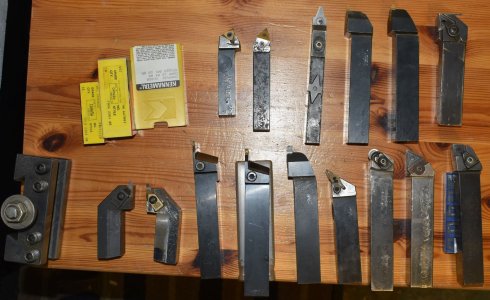

I have a very small 7x lathe, and I find that the 'for aluminum' inserts work better for me, even on steel since they are sharp enough to take light cuts.
One minor bit of advice on insert tooling @curmudgeon
I have a set of import tool holders and associated inserts. The tool holder are generally OK but the inserts are about as durable as crackers. I splurged and bought a brand name tool holder and inserts and noticed a really big difference in cut quality and durability.
