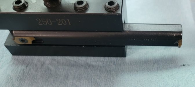

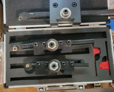

Susquatch Adventures Page 5 - Boring bars.

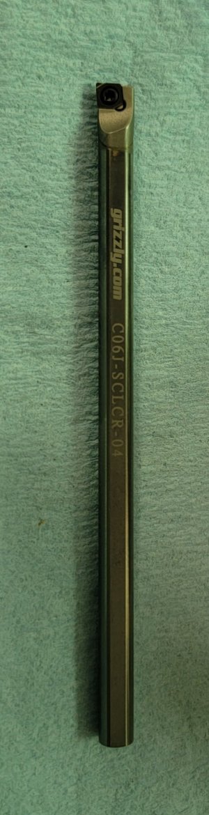

So this is another area where I have come to love Carbide Inserts. In fact, with very few exceptions I seldom use HSS boring bars. One exception is the one above in HSS Turning. There are a few others.
The other thing about boring bars that breaks the pattern is that I actually do like the kits they sell.
Here is my favorite. Note how well used the bars all are as well as the fact that I use them enough to dedicate a tool holder to them. One is missing because I loaned it to a friend.

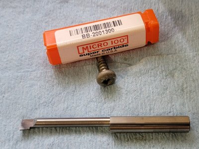

I have two other bars I really like. Both are tiny little things for boring small holes. This one is for 1/4 inch. I have an even smaller one for 0.2160 inch but like so many teeny tiny things, I couldn't find it for this post. It is solid carbide with no insert.
Edit - found it - photo added below.
So ya, carbide insert boring bars are wonderful things AND in the case of boring bars, IMHO buying a set is a good economical way to get them. For boring bars, a set makes sense for lots of practical reasons IMHO.

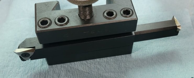

I do use Carbide Inserts in the form of a Mesa Tool. It has both outside and inside threading inserts. Its a great tool, but not my favorite.
My favorite is actually a HSS insert tool by A R Warner. Yes, you read that correctly. It is a HSS Insert. It's sort of like the Mesa in that it is double ended. But the magic is that the inserts are HSS. Apparently, AR Warner is hard to reach right now. I don't know why. It's a small family business so who knows what tragedy has befallen them. I bought my first one from Brownells sold under their own Brownells brand, but it's an Arthur Warner. You can get replacement inserts from Brownells too. Like the Mesa, the Warner is double ended for inside and outside threading. But its a bit longer and fits a tool holder better. It's also a trigon style insert with three usable points. And because it is HSS, it can be sharpened - albeit very carefully.
I left this tool for the very last for a reason. It is my all-time most favorite turning tool of all. If something has happened to AR Warner and the tool disappears, I will feel like I lost a good friend.

I wonder if this insert will fit the two (left & right) CCMT holders in that useless kit of mine? If so, I'd be willing to give them a try. Not sure I feel inclined to buy new holders though......
I confess I still don't like the fact that they are not designed to take a smaller cut than 2 thou. I never did like taking a finishing pass over a thou. I like to sneak up on the desired dimension. That said, maybe @Dabbler s trick of honing inserts might make that possible.

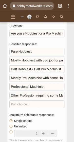

Nonetheless, it's still a very good question. What do you think about starting a special thread with a survey and ask the active membership to self designate themselves?
Here is a screenshot of a proposed survey. What do you think? Is it worth doing? If so, can you suggest any improvements?

Thank you for that comment. It helped me see the flaw in my thinking. I don't think how much money one has invested in their hobby is a meaningful qualification. In fact, I even think Jay Leno is indeed a hobbyist.
I found this dictionary definition (the same across many dictionaries) to be most compelling: A hobbyist, is “a person engaged in activities, in their spare time, that bring them pleasure.” No place did any definition I found speak to money or even being paid.
I also found this rather elegant and comprehensive on-line discussion about the difference between pros and hobbyists. It seems that you and I are not the only people interested in the issue.
When the dust in my mind settled (lots of that in there), I decided to delete my proposed survey and move on. I think doing the survey would be divisive (us & them) and personally, I would rather be inclusive (all of us). If someone enjoys our hobby and is willing to give their time to help others, then I am simply grateful - I really don't care what their resources are. So I have no problem calling the vast majority of us hobbyists on here. But that doesn't mean I'm gunna run out and buy $200 inserts. In my dusty old mind, we can and do all have different value propositions that each of us needs to decide on our own based on our individual needs, budgets, and enjoyment. I guess I would also add that I think it's really great to get a wide range of advice to help me make those decisions - especially if it might be expensive!
