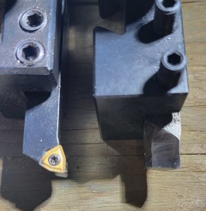

@Degen are you sure these inserts/toolholders are meant for general turning? The pocket (support) is aligned to suggest plunging like making a groove or fillet operation. I've also seen them in lathes used for profiling / blending, but usually CNC. Or facing mill heads in a mill setup.

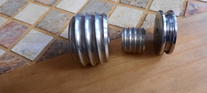

I have a 6mm insert / toolholder like yours. On my 303SS valves I tried turning the stems with the same tool since that also becomes the blend radius. It was not pretty. Significantly more load imparted to the part vs a smaller radius conventional cutter for the same DOC. I've tried the same cutter in other materials for finishing, aluminum & steel. Performs about as I expected. There was no advantage over conventional lathe inserts with say 1.5mm nose radius. I would not run a HSS tool of that equivalent 6mm radius (at least not on my 14x40) because the tool contact line is significantly longer than a conventional cutters even though is suppose the round insert is stronger. Hobby machines generally have less rigidity, lower HP, looser slide tolerances - usually a recipe for chatter.

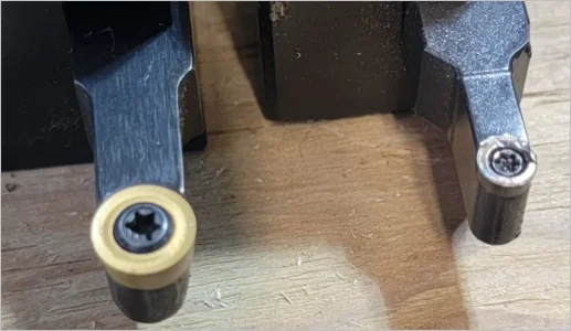

I have the others set ups as well, for heavy stock removal I use the larger of the 2 generally, the smaller one of mine is straight like @Susquatch and cuts left/right faces and in both directions very similar to a well ground HSS bit while allowing faster feeds (radius nose) maintaining a smooth finish compared to pointed bit. It has become my do all cutter on the lathe as it is one setup multiple choices for cuts and it leaves a nice stress free radius in the inside corners.
Peter - your question was not directed to me. But the picture you linked was mine not Degens.
I don't usually use those tools for plunge cutting but I have done it. I also don't use them for general cutting like degen said he did. Mine are mostly reserved for those times when I need a better finish. They do a great job of that for me. I don't know why your experience isn't the same. Perhaps you are taking too big a cut? I find the round bits cut almost as good as a shear tool. On shallow cuts, they almost seem to peel off a very thin piece of foil. The resulting finish is usually very good. I also run them a lot slower than one might guess for a carbide tool. That's what trial and error has done for me. That works for almost any material from stainless to 4140 to mild steel to brass to aluminium.
You are right though, they also work well if you need to contour a surface manually.
At any rate, unlike Degen, I don't consider them a general purpose insert. I will almost always reach for HSS or a Trigon insert for general purpose work.

For those who are wondering, these are my two hogging tools for removing a lot of material fast - though not as fast as @thestelster ...... That man drives an F35 to work every day...... I have a Clydesdale.
I might help to understand that my main source of stock is old bolts - of all sizes and strength from little screws to massive 2" bolts with 6 pitch threads. So hogging is often standard procedure before I can get to the required work.

@PeterT Th button inserts in post #122 can be used for hogging on *very* large machines. For a vid of someone doing this look at recent hydraulic cylinder rebuilds on youtube - Cutting Edge Engineering.
BUT Curtis is using a 15 HP or 20 HP lathe (he has 2) and each lathe weighs more than your shop, and he still gets chatter.
Using button inserts on a 3HP hobby lathe is limited to light cuts unless you are a 'machine abuser'.
@PeterT as well,
I use the button style inserts on the CNC lathe for the most part.
They do hog and produce nice surface finishes as Dabbler mentioned above.
They only time I would use them on a manual lathe would be if I have a quick 1 off shaft or bushing that needed grease grooves.
The cutter bodies come in another style for internal grease grooves as well.
This is what I use that style of holder and insert for on CNC, not so much for manual machining.
It takes a good amount of horsepower and torque to push this style cutter. That's why they don't work well for the hobby guys with smaller lathes with limited torque and horsepower.
Fair enough. His post showed 2 toolholders with no further elaboration or distinction. The one on right looks like a neutral toolholder which is what I was referring to. I'm suggesting the toolholder pocket orientation & thinner shank under the insert is probably suited to mainly oblique or plunge orientation vs side load. Hogging or even heavy cutting is heavy sideload.
As for your second question, nope, the lightest of cuts. I just don't see the improvement over say a 1.5mm radii conventional insert toolholder. I can take a picture of a half thou shaving coming with a mirror finish using conventional insert but I don't really have a horse in this race. Use whatever gets you the results.

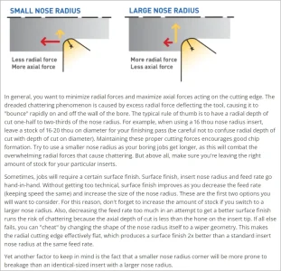

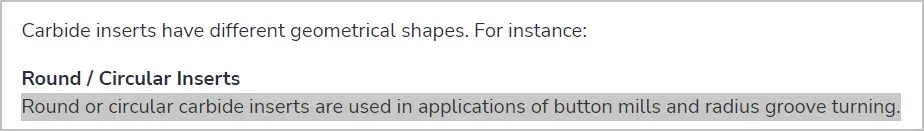

I'm trying to find some references (from insert manufacturers) that recommend a large radius or circular insert to be preferable for finishing cuts. Seems like what they call finishers come under variants of their conventional (faceted) inserts, with other geometric features, nose radii, rake, coating... variants. But I haven't looked too deep. Do you have some links?
Large diameter strikes me as counterintuitive. I mean if 6mm round insert makes a better finish than 1.5mm radii faceted insert, why stop there? Increase the radii to 10mm, 15mm? To me, its because diminishing returns and/or as contact arc increases, other factors enter the picture: rubbing, friction, heat, chatter, smearing... all anti-good finish attributes. The increased arc length is not like a mill cutter where the helix & turn orientation control chip thinning & other attributes. On a lathe, the entire profile is in contact with material.
I never said that manufacturers recommend this. It's just what I found from my own experimenting. Also, it's worth noting that ALL MY INSERTS ARE CHEAP CHINESE INSERTS. I don't have any really good ones yet. I don't have any good holders either. That's the whole point of my search for recommendations from other members. I have no stomach for buying and testing dozens of very expensive inserts and tool holders only to find that they don't work because because because. I think there are a lot of other hobby machinists who could benefit from the same advice.
Well, it's not that I disagree. However, one could make the opposite extension of logic. I mean if 1.5 mm makes a better finish than 6mm, why stop there? Why not 1mm or 0.5mm? We all know that doesn't play out very well.
I don't think either logical direction holds water. Instead I expect that there is a sweet spot and furthermore that the sweet spot depends on a whole host of factors. For example, the one photo you attached shows a pretty aggressive depth of cut.
When I use round inserts for finishing purposes, my depth of cut might be 10 to 5 thou or even less. So the cut does not involve the entire radius - only a very small arc of it.
