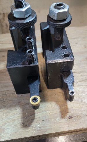

If you are you are going to try one for general turning I might suggest these, I love them since I started using them.
Couldn't agree more. I like them too. Here are mine.
Note the damage on the small one. But to be fair, it has a lot of miles on it.
Not visible in the photo is the grinding I had to do on the big holder to get decent clearance. The original could not be used for face cuts without turning the tool post.
There are two things I especially like about these inserts.
1. They can be simply turned 15 degrees or so for a whole new edge. One insert lasts forever. That small one is about 5 years old and has never been replaced - just turned it a bit to get a fresh edge. This has a huge affect on ROI.
2. They produce a very good finish even at lower speeds than specified. The only thing more reliable is a HSS Shear Tool.
As I said right off the bat, I am not Anti Carbide. Just not anti HSS Either! I think Gotteswinter is crazy despite @Dabbler's explanation.
I'm glad you posted these. I would highly recommend them for other hobbiests too.

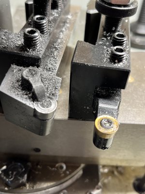

Would you say the chips shown on those cutters above ^^^ were produced with a good speed and feed for that type of insert?
I understand your experience. You KISS approach is obviously working for you looking at the chips that came off the inserts your learning to love .
Give em' a Kiss point blank.
Actually the chips on the larger one are from Chinese mystery casting, hard, but powders when you cut it.
The other is scarf from mill running hard fast cuts.

Typical recommended speeds for carbide inserts I've seen bandied about the net are around 2,000 rpm. Considering my old lathe maxs out at 1200 I'm not sure why I'm even considering trying carbide inserts. If as @Susquatch points out the majority like myself are just hobbyists taking our time with limited resources why am I investing big bucks in a brand name QCTP that requires dozens of expensive tool holders, expensive carbide inserts and is better suited to inserts than HSS!? Why not just stick with the freeby old lantern toolpost which may be best suited to the HSS which my lathe is best suited and designed for? I'm afraid that if I were honest I might admit that it's just because QCTP's and carbide inserts are sexier and nothing else!
Well, 2000rpm might be suggested for some materials and certain diameter work. My lathes max speed is 1000rpm, and I use carbide inserts almost exclusively, but I do have HSS bits for certain applications or scenarios. I think having both systems in your arsenal is advantageous. But there are certain situations where HSS will not work, ie turning hardened parts. Or inefficient ie, turning a large diameter part, where the suggested speed would be so low that you risk falling asleep. I will extend an invitation to you or anyone for that matter, to come over to my shop, and we can try several cutters, and you can make an honest opinion. I know you're in Hamilton, but if you come up to the Keswick area feel free to drop by.
Ok... I will give you that 1. Hard Chinese mystery casting that turns into powder while machining it.
I think they call it swarf/turnings or chips but it any case,
What were your speeds and feeds during your hard fast cuts producing those chips on tool #2 ? Also in what material... to help other members understand what the chip loads and chips will look like if they were to try this.
