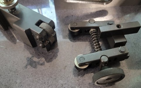

Ok, so here is page 1 of Susquatch's adventures. I'm gunna start with knurling cuz it's the easiest.
IMHO, Left is nothing better than junk. Right is nothing to brag about, but it works. Left depends on toolholder pressure against the work. Right is independently clamped down onto the work as the knurl progresses. Left is big bucks junk, right is cheap but effective. Your mileage may vary.

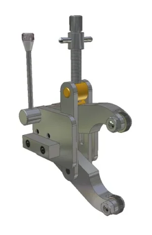

@Susquatch : I have plans coming from England to build this:
I will be taking the left hand unit you show and chopping it up for use as the mounting arrangement and re-purposing the wheels for the unit itself. I also have a couple sets of straight wheels that will go into play. I will, of course, be posting the results of this build.
It is a Hemingway Kits model. - I just ordered the plans - not the materials

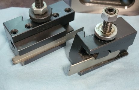

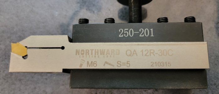

Page 2 of Susquatch's Adventures. Parting.
This is a really nice tool. It was given to me by another member cuz it was a 1 inch tool. I milled the bottom off to fit my BXA Tool Post Holders

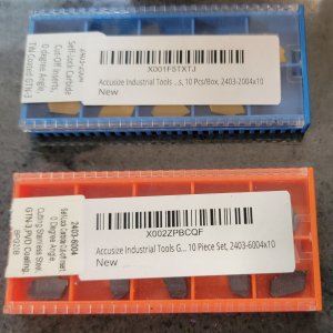

Here are the two styles of inserts I got for it.
I didn't get any aluminium inserts cuz aluminium is easy to part with almost anything.
This sucker works. And it works GREAT.
Before I got it, I used HSS with mixed results. Parting conventionally has always been a challenge.

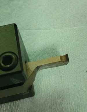

The best solution which has NEVER FAILED ME, it to cut in reverse with an upside down parting tool. You can cut big, small, or whatever. It might make noise but it works. Here are two different types of HSS parting blade setups. Both are setup for parting upside down. I wonder why I have two holders setup that way.......
One is a T-Blade and the other a wedge blade. Both work fine in reverse. But worthy of note is the holder in the left photo. They work fine upside down but totally completely suck used conventionally. My advice is to avoid those adapter holders like the black plague.
One of these days, I will make a super rigid holder for parting. That will be a separate thread all of its own.

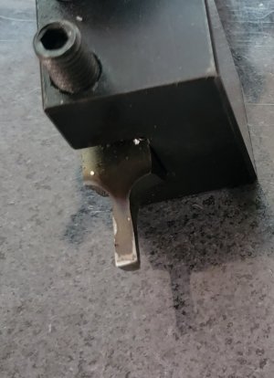

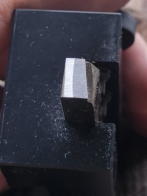

Here are a few special grinds I have done to try to part when the part didn't want to part.

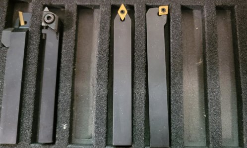

When I got the bigger lathe 10 years ago, I bought one of these kits.
Do not waste your money. I only use one of them. The rest just gather dust. IMHO, buy a good one of whatever you think you need. It might cost as much as the whole set, but you will use it.

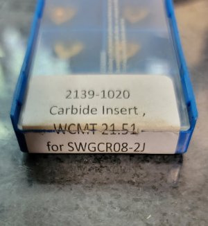

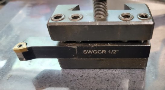

Here is my favorite insert tool and inserts for it.
I know, it's a trigon WCMT. Seems they are not very popular. But I like it for most insert turning. It has 3 working edges, does a good job of breaking chips and leaves a decent finish. Seems most users like the triangle inserts. I've never tried them, but plan to cuz it's hard to argue with popular.

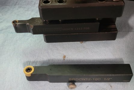

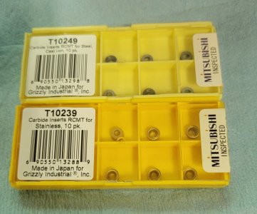

The other insert tools I use a lot are the round RMCT Inserts.
They leave a great finish and are not very sensitive to feed and speed etc. You can see I use the small one a LOT. They also last forever cuz you can just turn it a bit for a fresh edge.

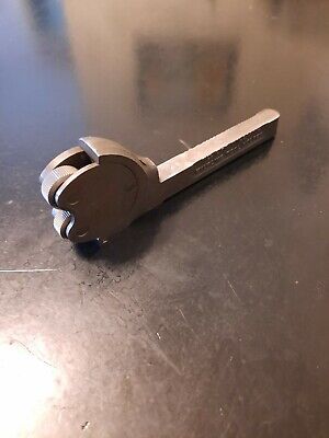

Interesting about your experience with the knurling tools. I have a J.H. Williams tool that came with my Myford and I've been happy with its performance. I haven't tried one of the scissor versions and I looked at all the pinned hinges & joints in them (tolerance/alignment??) plus needing to clamp the wheels onto the work piece and didn't like the look of them!
With a scissor I also wonder how you keep the correct crossover indexing distance between wheels to make the perfect knurl pattern? With the Williams you have to knurl on a diameter incremented in 16ths to get a coherent cross over pattern.
My Williams looks like this (photos from the web):
@Susquatch I wonder if you had a parting tool holder like this it would make parting with HSS blades more fun? I've used them on several machines and even on my light Myford it gives good results unless I try to do something dumb.
The holders you show don't look like they provide as secure/rigid/support on the parting blade letting it or the holder flex and nothing good comes from that, just ask me....

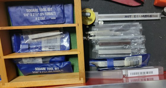

At first I bought small 1/4" blanks cuz they were cheap. But other than a few special applications, I pretty much buy 1/2" and even 5/8" now. My BXA Tool Holders are 5/8.
All the reasons others like HSS apply to me too. I especially agree that learning to grind, understanding reliefs, cutting edges, nose radius, etc etc etc are all very valuable knowledge and skill sets. Despite using carbide inserts a fair bit, I do not advocate inserts for new machinists. There - I said it out loud.

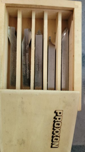

If a new machinist really wants to start turning before grinding, go get a set of these. The quality is great and they work right out of the box. This is probably my 4th set.
And here is what I usually buy. I like 5% cobalt. It holds an edge much longer.

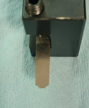

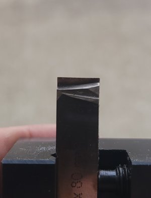

This is a special chamfer tool. It cuts a nice radius on the inside or outside of a tube or drilled or bored hole, or on a shoulder.
This is a shear tool. It shaves the surface leaving behind a beautiful finish.

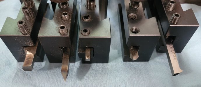

And from left to right are:
A really tough turning tool for bulk material removal. It looks rough and is rough, but the edges are well honed. This thing will take off a lot of metal very fast. Note the heavy top rake to bend the swarf out of the way.
A really sharp pointed tool for getting into really tight places
A front end shear tool
A 45 degree chamfer tool - use forward or reverse to chamfer the edge you want.
A deep inside threading/boring bar combo. (threading coming up soon).
If you look closely at the second and third tool, you will see that they are shimmed to fit the tool holder more solidly and also to put the business end where I want it.

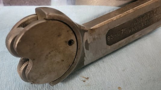

I have one very similar made by Armstrong. It worked ok on my old lathe. But not on the new one - mostly because it was intended to be used with a lantern style tool post. I like how both of ours pivot on the work.
The scissor knurler I have works great even though it is really really poorly made. Some things you just can't explain! The problem with the pressure type is the lateral force required to knurl the metal. The scissor type just floats with the work.
I can't wait to see @Brent H s when he gets it done. I suspect that there will be one just like it on my bench soon enough. I really don't like crap even if it does work..... LOL!
