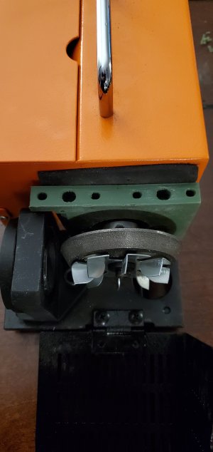

My parts were printed on a printer that had not been calibrated, and I'm finding the 28mm bores wont accept the chucks without chamfering and sanding.
@DavidR8 can you let me know if this is an issue when you visit @YotaBota please
My 8mm threads formed very well, and I ran them thru with one of my many 8mm taps. The tool insert block snapped right into the block holder...

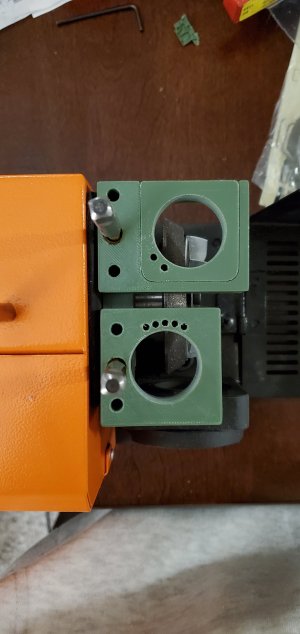

So I noticed another issue. The motor boss wont fit into the motor mount. It is printing smaller than the actual model. I made the tolerances too tight. I had to sand mine which is frikken annoying. I'm making new stl file with slightly larger opening..
Duo Motor Mount Rev2

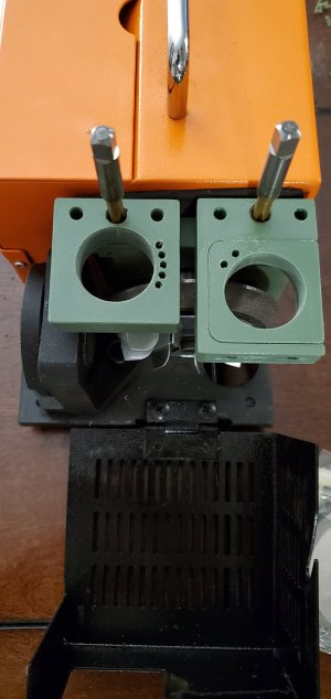

Temporary solution to hold the block in place for a photo using two 8mm taps.
Can't it be machined?
well my parts were not printed with a ton of walls, so you can only remove so much material before you cut into the hollow infill section.
I'm just being whiny... sanding is not that hard but for the next people that print this I've uploaded a better file
