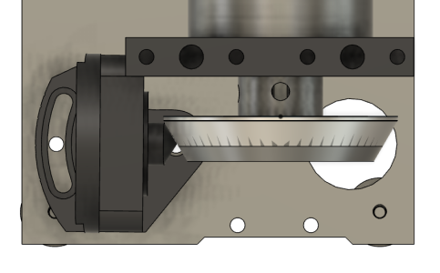

The 20G wheel being 33% thicker allows wider bits to be ground, but pushes the axis of the grinding seat outward from the grinding wheel. In the image below the pointed rod is 14mm diameter.
So, options to handle a 20G wheel. Machine new motor hub that sits a further 3 mm onto the motor shaft, and new A and B tool blocks for the 20G wheel, and make a 20G tool setter to provide the additional projection on the bit that will be required.
Or make a new dedicated 20G machine. I'll design blocks in either case.

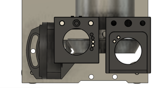

NOPE.
The B tool block can't be set back towards the upright motor mount any further. The A tool block could have remained unchanged because the insert could be shifted outwards.
Moving the grinding seat location is not practical. Maybe move the motor base back instead. Or just make a 20G duo machine

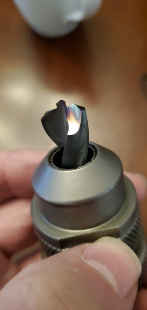

So I finally put the grinder all back together and did some test grinds for fun.
I wanted to see how easy the grinder cut so I set a long projection manually and went to town on the web thinning...looks like I made a step drill.
When I reassembled the machine I set the tool block insert as far back in the seat as it goes, when it is supposed to sit forward. I made the adjustment and it cuts great. It removes material very quickly.

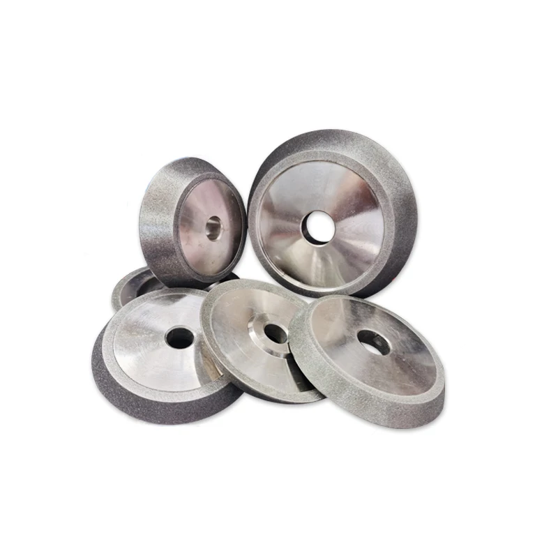

Yes I can order grinding wheels direct from the manufacturer at the same time as spare motors.
The wheels are $35USD each for the 13A, 13B or 20G. I dont know what they will add to the shipping cost but I'll assume 10 bucks each for now, so $65 CAD.

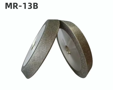

OK, the stones on my 13B are marked "13B CBN230" and "13B-B SDC230". I don't know how the 13A stones are marked nor what any dimensional differences are. But I can certainly measure mine if needed.

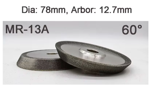

The guys selling these on Aliexpress describe the 13A and 13B wheels the same, as 78X12.7X10XV60 230 grit SDC or CBN.
I think that the difference is a shoulder on the 13A stone and a sharp corner. My two 13B stones have no shoulder and there is a short section of the grinding edge that is flat.
Here is a screen shot of the 13A stone.
And here is a photo of one of my 13B stones.
Except for the sharp edge, adding a shim would make a 13B stone work on a 13A machine. Cutting the arbour back might make a 13A stone work on a 13B machine except for the implications of the sharp edge.
I believe that the wheel thicknesses are the same.
I believe that we can make either wheel work, but for a duo machine the A wheel profile may provide optimal results due to the thinner flat at the back face of the wheel. It may perform the split pointing more finely.
So the back of the 13Bs are flat while the backs of the 13As are a depressed bowl shape! I can actually feel this on the back of my 13A wheel. Didn't realize that before. Explains why I was having issues measuring the thickness because I had assumed the back was also flat.
