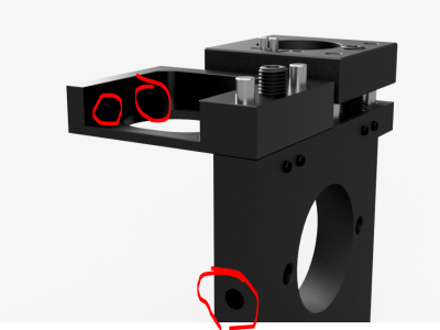

Any idea what size reamer to use to cut both free and tight pressed in holes in the base and the holder?

One thing that can be problematic is trying to open a bore in soft plastic. The spiral flute pulls drill off center. Straight fluted reamers work okay. I'd use a 5mm reamer if you have one.
One other thing is how the parts are printed. My friend used general supports everywhere, and they clogged the bore and were a PIA to clean out. The better option is to bridge the 5mm hole and not use a support that needs to be cleaned out.
I guess I wasn't clear. I wasn't really asking about spiral or straight. You need the block to float (slide) on the pins and you need the pins to stick in the steel frame. So two different reamers will be required. Wondering what the plan is for that? I may need to source the reamers as I don't have any metric at all (that I know of right off the cuff).

I adjusted hole sizes because they holes have printed a smidge under sized on multiple printers. I also lowered the overall height of the motor mount, the A tooling insert, and the A tool holder to allow the split pointing cut to sit lower (3mm IIRC). I hope this is enough, but if not I'll make a major revision to the design, because the split point cut is the whole point.
I added 3 mm threaded insert fitted from inside of the cut out. This may be tricky but will allow the best tightening to retain the insert in proper position.
The cover fastening hole has been adjusted to suit 5mm inserts found on amazon rather than more expensive inserts
