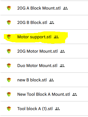

I updated the parts folder to include 4 new parts.

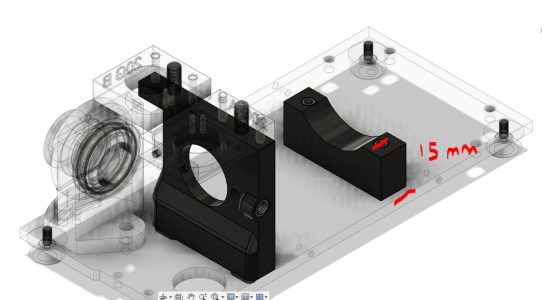

One is a generic motor support bracket that is intended to friction fit under the far end of the motor so provide additional support for using plastic only motor mount.

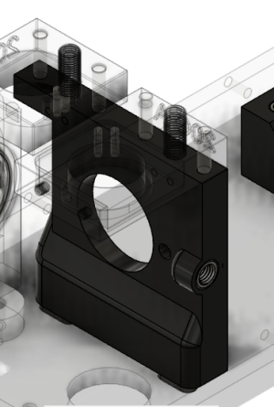

Then I've added a new "20G motor mount" that will allow for the proper positioning of the 20G wheel relative to the standard 13A/B/D grinder seat. The base set back 4mm and has extensions that insert into the slot in the base plate. It also has a boss to install a heat set insert for the cover screw.
I've added "20G B block" that centers over the chuck over the rear of the 20G wheel, and I've added a "20G A Block mount" which positions the standard A tool insert over the front edge of the 20G wheel.

I made a wood block to support the motor while we test fit the printed parts.
NAH lets just have @DavidR8 print the support block too. Low infill, low wall count, down and dirty is all you need. Then it can be left in place.

The bottom of the motor mount is threaded into the plastic since the hole is deep it should hold fine, and an insert doesn't fit in the projection.
The top of the tool blocks are have an 8mm thread profile for now. I did not select an insert hole for it yet since it is prototype and sadly because I don't have 8mm inserts at the moment. I do have a buttload of 8mm taps to run thru the threads though.
The 2 holes on either side of the 8mm threaded hole are for 5mm guide rods. The guide rods are loctited or superglued into the hole in the motor mount. The 8mm grub screws need a profile machined in them and roll pins to hold them in place in the motor mount.

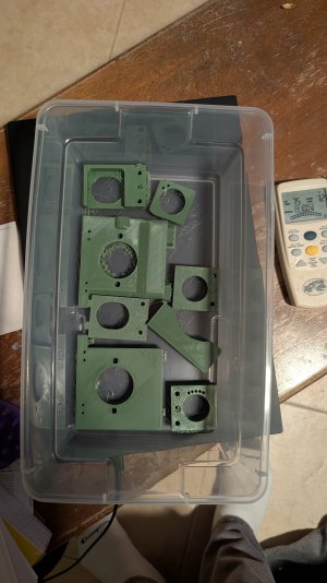

My parts were printed on a printer that had not been calibrated, and I'm finding the 28mm bores wont accept the chucks without chamfering and sanding.
@DavidR8 can you let me know if this is an issue when you visit @YotaBota please
My 8mm threads formed very well, and I ran them thru with one of my many 8mm taps. The tool insert block snapped right into the block holder...
