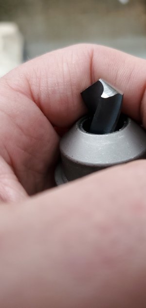

First cuts with my MR-13B vevor drill bit sharpener modified to be an MR-13D machine.

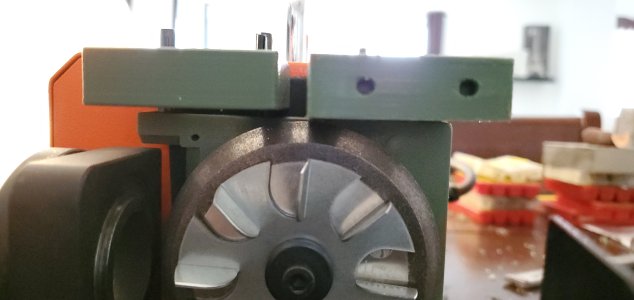

This is only with the plastic prototype parts held in place with wishful thinking and a few roll pins and without the tool plate adjustment screws. It performed exactly as I thought it would. More on that later.
Of course the normal drill angle grind via the grinding seat remain unaffected. So lets look at tool plate A depressed to it's deepest cut setting. This is supposed to be the point splitting grind. As expected the tool is tool high to cut appropriately. I expected this and was going to modify either the motor base, or the back of the tool block mount to have a recess to allow the block to move lower. As it is it barely grinds the corner you can just see highlighted below.

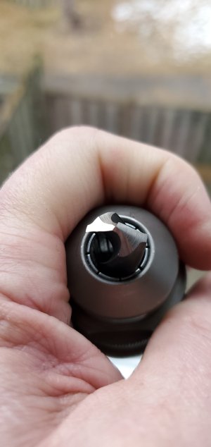

Now, on to the web thinning cut from the B block tool. I had this block elevated on a roll pin with a diameter of ~2.5mm. This is the result. I struggled holding the cell phone and trying to close focus but these pics should suffice.
To my mind this is near perfect web thinning and very close to a split point grind using only the web thinning setting, as I expected.
So I surmise that I can take 2mm off the duo motor mount height and then test the tool blocks again at that level after which I can reassess the next tweak to dial in the design.

I'm going to have to chamfer the edge of the tool block holder because there will be interference with the grinding wheel, and maybe take a 1mm off the bottom thickness of the tool holder as well...

For the first 13D kit that @DavidR8 has printed you make direct replacement of the motor mount assembly, then you add the two tool blocks and the motor support block. Easy peasy.
The blocks need a little refinement as they are now but not much. Since you're not connecting with David immediately I can make some revisions if David wants to print them too.
That looks pretty good & probably 99% of needs. (1) is something I'm noticing on my TCG sharpening contraption. An otherwise very nice facet grind but unpredictable edge as a function of the flute. The cheaper the drill, the more unpredictable the geometry. Has nothing to do with the grinder but its a byproduct to be aware of. I pulled out one of my Precision Twist HSS drills, no problemo. (2) those striation I know are magnified as happens with digital pics on metal & of no consequence since its all non contact relief. But presumably you have the same rake marks on the edge. This is where diamond grit & how good it actually is comes into play. Some of the Ali plates I've been buying (to hand dress stones & such) vary in quality. They literally dullen in hours of use whereas another will last & stay sharp. You need grit to hog but may find tune-ups can get away with finer #. Anyway for the money, that Vevor system looks pretty reasonable value to my eye.

The bit I have sharpened it from a really crappy set, and indeed the hooked front edge is a by-product of the flute grind.
That image the drill bit is missing the A tool grind so when it is completed it should be nearly perfect IMO. It will grind away the triangular area in red and provide a nice secondary relief to the cutting edge rather than that curved surface that falls away from the backside of the cutting edge. Yes the striations are magnified several times, and have no impact on the grind. Just one piece of grit larger than its brethren.

here is a different view of the web thinning grind. The result is very close to a split point. The split point grind will be the cherry on top.
I'm tempted to try to machine away some material so I can test today. Otherwise Monday night at the earliest for reprinted parts
That is about what I get with web thinning in the standard 13B and I'm not sure how much more beneficial a split point is than this. The split seems to be the holy grail though.

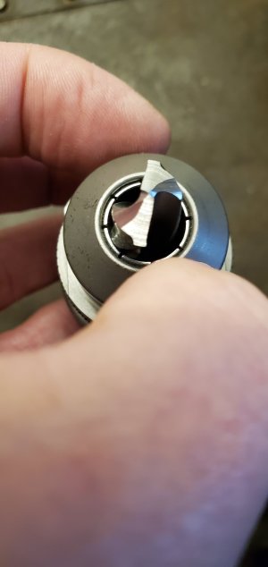

Seeing the discussion above between @PeterT and @TorontoBuilder about crappy drills, I thought I had posted some photos of what can happen with crappy drills but apparently I only shared those with @TorontoBuilder by txt message. I should have shared with everyone.
Better late than never. Here is a 1/2" drill from one of those cheap poop 115 bit drill sets.
Notice how the web grind is non-symetric side to side.
And here is the exact same grind on a brand new unused dormer drill. I hated to sharpen a brand new quality drill, but decided to take one for team non-cone.
These are all web thinning set to generate a split point.
