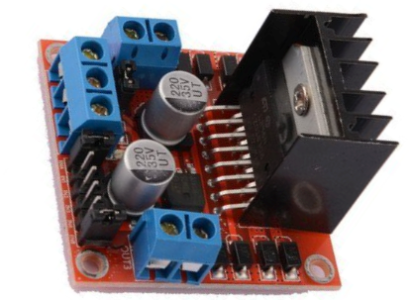

So for example I bought those little motor driver modules.
First thing to did was reverse engineer them and then figure out how to make them more reliable. Normally I've just posted a PDF of the schematic. But since @slow-poke uses Altium he can edit these now that I've added the files.
I may do a new PC board for this driver that fixes the errors and possibly even adds some features purely because at the moment the board with the terminal strips and motor driver is about $5 while just a brand new motor driver chip is $19. Even the Heat Sink is expensive. Therefore the idea is to add a socket for something like an ESP32 processor.
