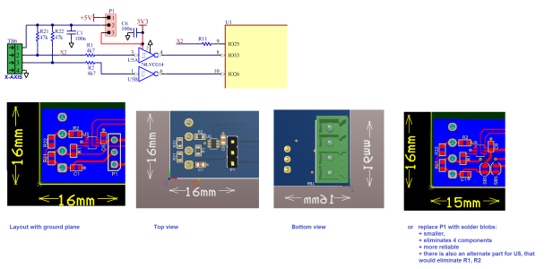

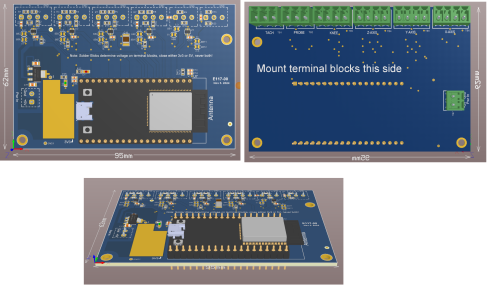

The fun part of electronic design is that there are so many ways to accomplish any particular design.
Here are a couple of possibilities that will only require about half your available board space and use less components.
I would actually replace TB6 with the DB and eliminate all the hoopla associated with the terminal block to DB wiring, you have enough room.
I'm not sure if Fusion imports Altium files, if it does your welcome to the files for these examples.
BTW with your original schematic. if the intent was to power the board with 5V, your circuit won't work.

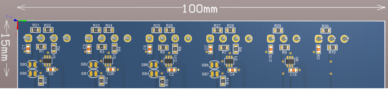

Okay, I have not done a layout for a while and I was curious so I spent an hour to see what all six inputs would look like space wise. Answer we only took 15% of the available board space so the board can be a lot smaller if desired. Requires some clean-up and re-annotation, but at least it has a ground plane and proper decoupling now. I'm off to the pool for my daily swim, will check back later.
Man, what a difference it makes when you know what you are doing! SMT also offers a lot more flexibility on a smaller footprint.
I think my basic design compares favourably to yours - like a Kindergarten drawing compares to a Rembrandt!
The design and layout I used is from Yuriy, so I can take no credit (or blame). His webpage explains that the board can take inputs from scales that use either +5V or +3V3. The ESP32 has inputs for both values. My assumption is the board functions at 3V3, and the +5V in is in case you want to send 5V out of an IO pin.
Having said all this, I'm going to look seriously at your files. If I can steal them, you can bet I will! One big question in this who process is would what I design end up working in the real world. Up to this point, I think the answer is a resounding "no". But it's been a fun trip! :p
