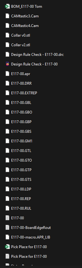

In addition to the gerber/drill files for the PCB, they just need the BOM and P&P (Pick & Place) file. I can't recall if I sent that but it's certainly available if needed.
Hi guys I would be interested in two boards for the group buy if its still a go?
Or if no group buy I would be interested in the gerber files and I will order my own. I have am getting ready to order nanoels boards from jlpc and I can add more to my order.
@slow-poke
This is what's in the file @Tomc938 gave me
Looks like you have everything, except...
The schematic as provided by Yuri? requires some components to be populated and some not to be populated depending on the type of scale used.
I'm not sure how many people actually use the "cheap" 3v3 scales, I know I wouldn't.
If this proceeds I'm not against tweaking to simplify and improve. I simply reproduced and corrected where necessary the schematic as provided. It works, but I don't like it and simple improvements can be made that will lower the parts count and cost.
