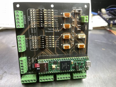

Schematics and Circuit Board layout with Fusion 360
So I'm currently in a holding pattern. @slow-poke designed an awesome board layout and I've sent the files off to be manufactured. I ordered the SMT components from Digikey and they arrived a couple of days ago. Man, some of them are small!! Here's some of the resistors:
I ordered the plugs and headers from Aliexpress as they were significantly cheaper, and harder to screw up.
I'm waiting for everything to arrive so I can start to put things together. I don't think anything is Canada Post, so hopefully the strike won't be an issue.

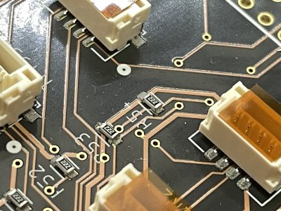

I put a blob of solder on one pad of each component to start. Next with component in tweezers and soldering iron in the other hand, warm the blob and position the component, once positioned wait a couple of seconds to cool and then solder the other pad(s)
IIRC there is only about 30 SMT components to solder.

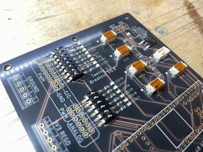

The times I've done smd's I have had the best luck doing what @slow-poke does, melt a blob on the pads, place the part, and melt it into the blob
Blob being a relative term....really just enough to make the pad raised with solder
seems to work reasonably well, but I would like to try paste at some point

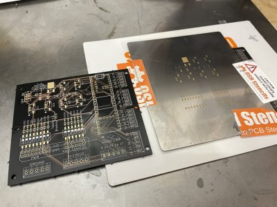

I did a pile of prototypes a while back with 0402 components. Squeeze some solder paste onto a toothpick, drop it on the pads, place the component with clean tweezers, repeat. Then drop the whole thing onto a hot plate (I have a scrap pan I use on a cooktop) until the paste flows. Sometimes you have to poke a component or two while they are floating to have them suck down in the right place.
Magnifiers similar to these, but the ones I have are no longer available.
https://shorturl.at/pB7Q2
I just might just have to try these. I think I've tested 4 AliExpress specials so far, still not entirely happy. Either junky, or fit was poor or crazy forward mass center.... My fallback is Optivisor because I can keep my glasses on & they swing out of the way. But they are limited in magnification & somewhat cheesy head band. I must have an odd head.
I really like the paste over solder wire. Once a guy gets used to using the heat gun it works really well. With paste less is more. To much paste makes a bit of a mess. Easily cleaned up with solder wick so not to big a deal. I will have to try using a regular hot plate. I have one of those cheap ones with a pan I use for heating things like bearings and hobby stuff.

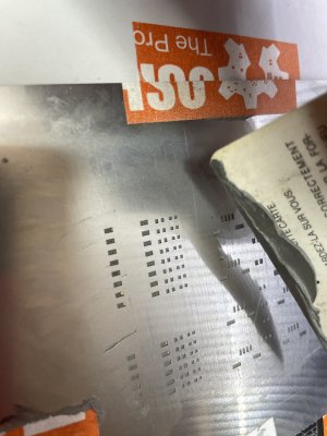

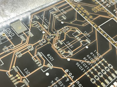

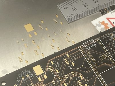

Here's a photo walkthrough of how I use a stencil to set the solder paste...
This is a laser cut stainless steel stencil, but mylar is a less expensive option. The squeegee is a credit card.
You only need a tiny amount of paste, and it is quite sticky so the tiny parts tend to stay in place unless you sneeze.
Then it is carefully loaded into a small toaster oven controlled by a PID controller set to the solder ramp.
With all of the SMD parts in place, the remaining through hole parts are added.
Total time from stencil to finished is around 30 minutes for one board like this.
