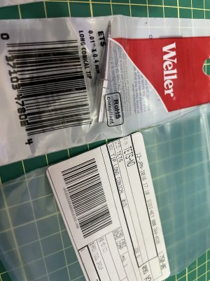

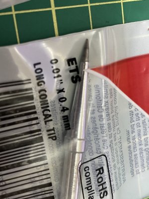

Question for those with more experience than me (almost everyone here) in soldering these micro-components: I have a Weller WES51 soldering station. What size tip should I use? I currently only have the tip that came with the unit, and it's large enough to solder door hinges on a Ram 2500. Well not quite, but compared to the resistors it's huge.

I'm not really up to speed on the Weller stuff, but possibly ETS or ETH or ETU, ETV , but confirm compatibility with WES51

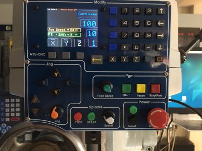

I rattled this little custom interface board off fairly quickly, because the board itself is quite simple, just a bunch of momentary push buttons and a touchscreen display connected to a small uC, that talks with LinuxCNC. It's "a little rough around the edges", 3D printed buttons etc, but good enough for hobby use.

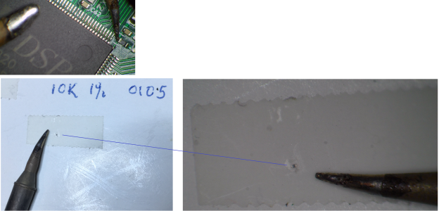

I snapped an image to show relative tip and component sizes.
This board was done in 2010, and could be soldered by hand. The DSP chip is only 176 pins with 0.5mm pin spacing so not dense by any means compared to say the high density packages on the QorIQ board I showed above.
R64 is 0603
The large tip just to the left of "DSP" is probably similar size to your existing Weller tip
The small tip next to R64 (0603 black resistor) is a STTC-145 (0.4mm wide tip).
Now the small part...... same STTC-145 tip next to a 01005 10k resistor, the entire component is about the size of the one pad of the 0603. Forget about hand soldering these little guys you need a good quality P&P machine to do work this small.
