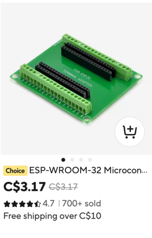

There are some ways around the different esp32 boards but they can get messy. I have used 24awg wire and wired pin to pin to make a board fit. It’s not pretty but does work, the hardest part really is programming the esp32 the rest is just soldering wires.
Another work around that is a little more elegant is to order an "expansion" board.
Again, you need to make sure it will fit the ESP 32 you are getting. Then just a matter of connecting the wires to the board and soldering them into the PCB in the appropriate place.
