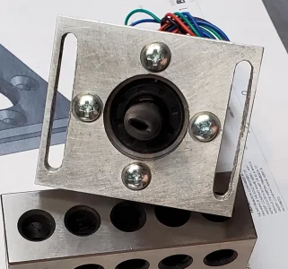

Installed the boring bar. Tweaked it to just shave the hole round. Now it's about 25.14mm instead of 25mm but good enough to locate the motor and it still lines up with the screws. Time to order all the metric socket and flat head screws. And one more flange to make.
The photo also shows more clearly how the 14 ipm feed with the 1/8" mill was way to fast when conventional milling.

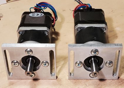

This one is better. Not the best yet. But better. At least the slots aren't all jaggy. I've ordered a bunch of flat head metric screws from Aliexpress. I still have lots of other parts to make before screws become an issue.
Two small 'oops!' on these.
One: Is that the slots need to be located 1mm lower so there's more body for tension adjusting screws.
Two: I thought I was using a 90 degree counter sink bit. Turns out I don't have any at all. They are all 82 degrees and metric flat head screws have a 90 degree bevel.

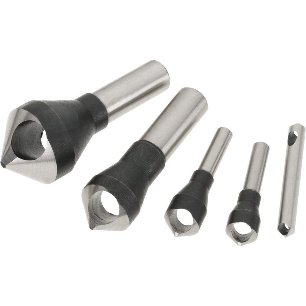

So the question is:
Any suggestions for one over the other? One flute, 3, 4 or 6? Coated? Uncoated? The diameter of the large part of the countersink in the drawing is 0.37" so I'm guessing for the 4mm screws a 3/8" countersink is the ideal size.
There are also 4mm and 6mm flat head screws in this project with the largest bevel being about 12.6mm for the 6mm flat head screws.
I know that you can't use a large countersink on a small hole since the cutting edge at the point might be too large for the hole that is being counter sunk.

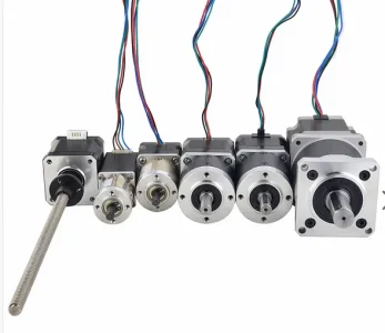

Where did you source the stepper motors from ?
There seem to be a lot of Chinese DC motors in the web, but, the ‘quality‘ is suspect.
Have you come across any reliable brands for drives and motors ?
Yes. I agree. A few years ago I bought one of these on Amazon. Hated it. High frequency noise when it was idle that drove me nuts. Sold it for half price to a friend who didn't care. It's still on his shelf the last I saw.
For the robot kit, unfortunately because there are so many planetary drives attached to different size motors that require holes in the back for encoders I bought this kit from StepperOnline but this time direct from China and not Amazon.
I also bought the drives from them. They were each cheaper than the two stepper motor driver chips I use in my ELS for the Z axis microstepper which is why I no longer supply the ELS with the drivers.
So having said that, when I had problems with the noisy StepperOnline I ordered, along with some AC Servo motors two stepper motor drivers from Bergerda. More expensive by about 25% but the difference in quality inside and the size of the heatsink for the same rating I think made it worthwhile. And no noise at all. Internally nicer quality.
I have not yet wired up or powered up these new StepperOnline motors and drivers. If they are noisy and whine I'll dispose of them and do something different. But the motors and planetary gear boxes were cheaper sourced as a kit.
StepperOnline now have an AR4 kit that has the encoders directly mounted to the back integral with the motors. Not sure about those either. And a new motor with integrated encoder that has a planetary gearbox with even less backlash. Apparently that was a problem.
The tiny motor driver is rated max 24V, the rest can go higher so one of these days I'll dig out a 24V supply and try them and report back.

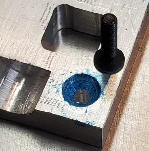

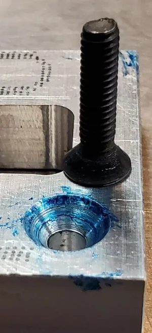

Good point. I have all the flat head screws. I'll take my protractor to them and measure. Should be interesting.
Step:
1. Drill 4mm hole
2. Countersink with tool measured at 82 degrees.
3. Add bluing to the hole
4. Insert 4mm flat head screw and spin with 2.5mm Allen wrench.
Notice the very thin line contact near the head of the screw.
5. Grab 8-32 flat head screw, insert and spin around.
This time the screw bevel removed a considerable amount of bluing. More than is apparent in the photo as the reflective shiny aluminum reflects the blue from the unmarked area. But a visual inspection shows a smooth removal of bluing.
Until the 90 degree counter sinks arrive I can't verify but I'd guess that the 4mm metric screw does have a 90 degree bevel as per metric specifications.
Well that was disappointing.
ON sale at KMS I though I'd give the 1/2" one a try. Each of the 5 cutting edges had a lip of metal folded over so they were anything but sharp. A bit of work with a flat diamond plate at least got rid of that lip and it's got a bit more of an edge now.
But, unlike the picture on the web page, the cutting edge is not straight. It's approximately 90 degrees but it's more of a curve than a straight line so one tiny point might be 90 degrees. Since it was packed with plastic formed over the cutter that wasn't apparent when I paid for it. Not until I got it home did I see how rough the sharpening job was. I'd guess a 20 grit stone...
Of all the zillions of countersinks I’ve tried, overall the best results have been with these:
And the trick is low and slow. I use them by hand in a carpenters brace for aluminum sheet, and at the slowest speed on my drill press for heavier stuff.
