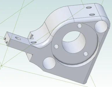

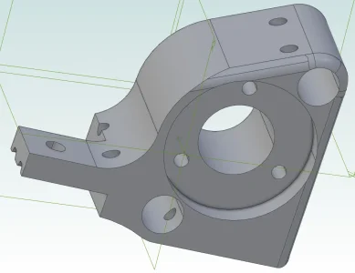

OK. So I caved and did some more drawing conversions. My friend Joe has Fusion360 and he's been able to create step files from more of the STL drawings than my Geomagic can. But here's an example of the J5 Motor Mount translated by Geomagic and saved directly as an Alibre AD_PRT file.

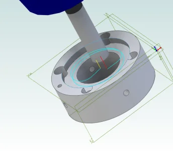

I then loaded it with AlibreCAD Rev.25 and ran AlibreCAM 2020 to do some profiles. Normally I'd do this on the lathe given the piece is round but this is still all an exercise. The assumption is the center hole has already been drilled out and I'm just profiling the round recess. I added a 40mm diameter circle to the face and used that to guide the CNC tool since otherwise it didn't like the counter sinks. ie. the 10mm tool bit went around the holes.

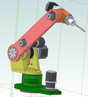

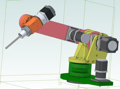

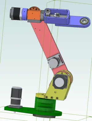

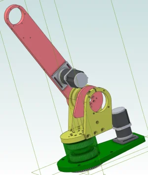

And another progress report. Pivots and rotates around all the joints so far. Need to create the Size 23 motor c/w gearbox for the arm motion and clamp it into the yellow bracket.
That's cool. Are cog wheels 1&2 for a tooth belt between them? So what drives 3? Or maybe I'm out to lunch how the motion gets controlled
Yes, it's an L series belt or optionally he also designed it with two sprockets and a chain.

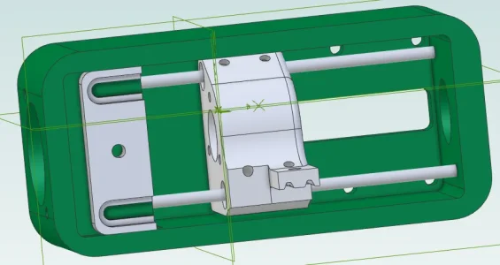

I have to draw up the angle bracket yet. The #3 pulley turns the #4 motor and arm assembly. Just working on that now. The lead screw nut on the #4 motor is in that movable part on the slides. The entire green box here is turned by that #3 pulley.

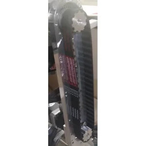

Here's a video to his belt upgrade.

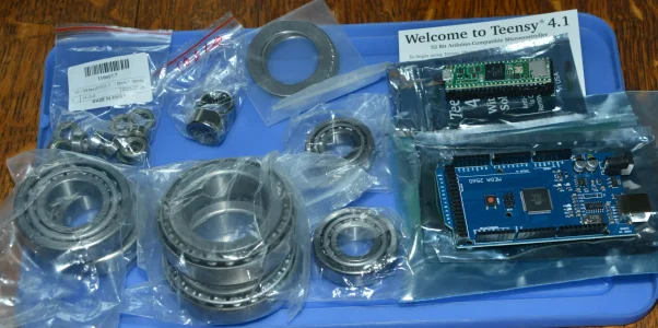

No excuse not to start turning some parts for that slip fit inside the bearings since they've arrived. More are on order like belts, pulleys, shafts. Need to decide if I want to order screw hardware. Like buy just two M4x14 flathead screws or a box of them.
I hope you have good luck with those bearings over time.
They maybe cheap bearings but remember, speed is very very slow. The fact that the needle bearings on one joint run on 1" OD aluminum tube suggests the designer didn't think it was an issue. I do so I might turn down a steel pipe to a smooth 1" OD finish. The inside has to be hollow because the lead screw for the next joint passes through it.
