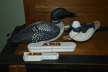

After major issues with my 3D printer I'm back to operational and now have 7 cover parts printed. I do believe the ducks approve.

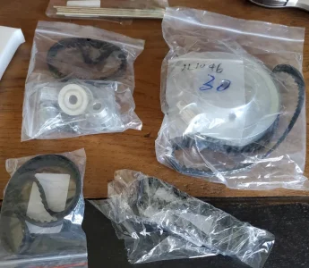

And the parts just keep arriving.
Where are you buying the tooth belts/wheels from & what tooth profile / pitch are they?
I had to get some HTD 3m for my next engine, they are a bid more obscure but I did find a supplier I used in the past.
One of the pulleys was sold ss XL profile but has curved rather than flat bottoms in the tooth profile.
Possibly HTD 5mm instead of XL 5.08mm
Might try a different supplier for that pulley.

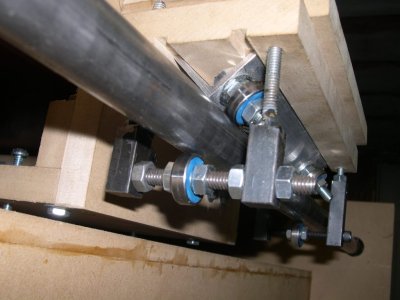

I like your creativity with the angle rail and bearings to reduce friction on the tube.
With less ‘wear’ in a hobbyist shop, I have even used PE slide guides from ice skate guards.
Re-purposing common items, can result in cost-effective components that last ‘hundreds‘ of cycles.

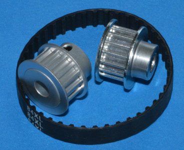

Here's an update on the incorrect XL pulleys. I only needed one of the 15T XL series. But they came in pairs from AliExpress reseller. For $5 or so including shipping. However they had the curved tooth profile for the metric pulleys. Even though the web site and the order said XL series. Pitch is 5.08mm rather than 5mm.
Now you'd think that probably wouldn't be a problem but it turns out there's a fair amount of slop between the XL belt and the metric pulley. Well today two XL 15T pulleys from a different supplier arrived. I held my breath hoping that it wasn't another identical screw-up.
Nope. They are beautiful. Also only about $5 for the two.

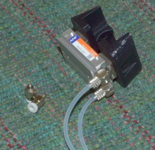

Also in the same package (AliExpress have been combining packages to save on local shipping) I received the 3mm OD x 1mm ID silicon tubing and both fast attach couplers and ones with nibbles to slide the tubing onto. The tubing is too software for the fast attach. However the other ones are great. Tubing slides onto the nipple and then the knurled nut threads on and compresses against the tubing to hold it tight. As it is it's hard to remove again anyway.
The other end of the tubing will go to a little adaptor manifold I have to make to upsize to the standard 1/4" tubing for the valve. That's 3mm threaded to 1/4" pipe thread.

Edit: What I meant is the XL pulleys are 5.08 mm while the metric ones are 5mm. And the photo is showing one of each and the XL belt just to show the differences.

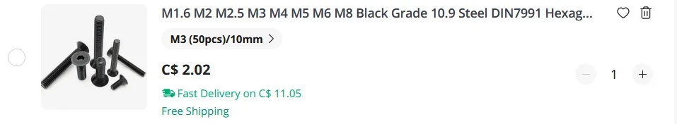

I have some free time which means I'm too lazy to go out and do yard work. So I thought I'd make up a list of the Spaenaur part numbers for all the screws in the AR3 Robot Arm kit.
There are number of flat head and pan head machine screws of the metric variety. For example M3x5 Flat Head. These are available in both Socket head and Philips head.
Another example is M4x20 Pan Head which is available in Slotted or Philips.
The question is: Socket or Philips; Slotted or Philips.
What are the advantages of one over the other? Assuming the price is similar.
I've been making up a list at AliExpress since I need 32 different screw types. I think I will finish the spreadsheet of all the screws and get Spaenaur to quote but for this cheap (well not really cheap) robot arm I'm not sure I need an extra 87 screws if I have to buy a box of 100.

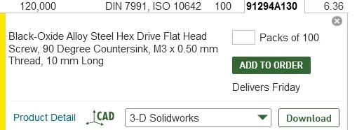

Even McMaster Carr can supply these of which I need 13 according to the parts list.
Where AliExpress wants 1/2 of that but of course I'll have to probably wait a month where McMaster Carr will ship on Friday.
I wonder if the quality is any different. Shipping is about $25 from McMaster Carr.
