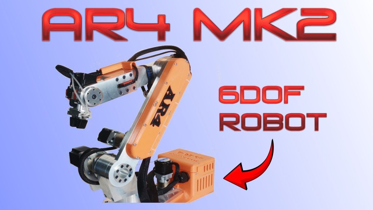

Yes. Open source for the Arduino interface. I don't recall it the PC side is open source. I think it is.
...... thinking about a new project are ya'. ........So many of my purchases and projects begin the same way ...😉
Don't forget, we like pictures. 😛
Actually already deep down this rabbit hole if you go back a few pages of this thread. The final toothed belt for one of the joints finally arrived. I now have the 3mm and 2mm broach keys for the pulleys and was working on the broach guide. A box full of motors, electronics, hardware.
Biggest thing holding me back now is to make a few patterns to cast the larger aluminum pieces. Not interested in paying $40 to $50 for a chunk of metal that I screw up when milling it. Much easier to melt it down and make it again.
What usually happens with me is something goes wrong and I go do something else for a while rather than break things due to frustration. The Z180 S100 card is now working other than having CP/M work with the MicroSD card.
This new AR4 version looks to have changed some things so I might be able to put off building mine because I need different parts. Here's hoping...
