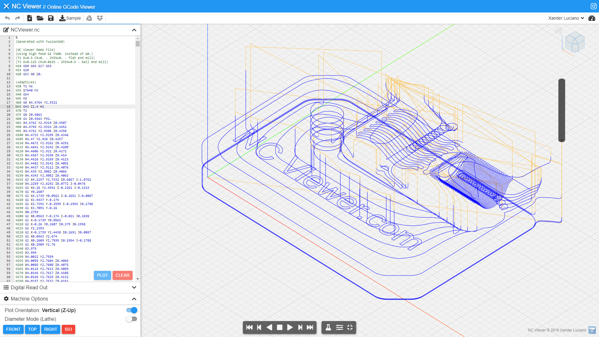

And I found this interesting online G-Code viewer.
