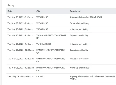

It was impressive. Here's the tracking info. Shipping was $21.84. One has to wonder why, if it's on the vehicle at 9:08 AM that it takes until 6:32PM to reach my FRONT DOOR.
Hamilton, ON to Victoria, BC . . . in less then 24 hrs . . . for $21.84 .
I think that is fair.
. . . next time, ask him to pick-up a Medium Double-Double . . . also !!

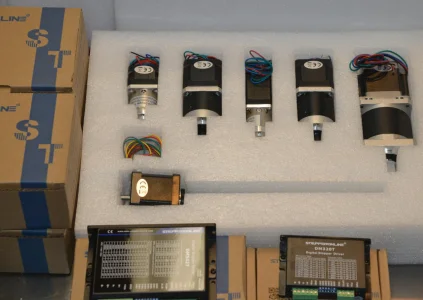

The motors have arrived. Just need to order the other 4 encoders. I was holding off in case I could use some I have on hand but the mounting holes are only for the CUI type.
Theoretically I can hook up all the electronics and move motors.

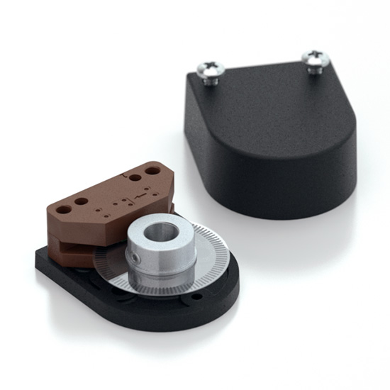

I can remember using ‘Hohner’ Rotary Encoders back in 1995.
Who are the main sources in the current market ?
CUIDevices is the big player for the low cost systems. US Digital still makes them too. The two I have cost me $150 each I think. And they ended up being really sensitive to noise so I finally swapped them out for the CUI. Then the real problem with the one DC servo showed up which had been masked by the encoder noise.
In the hobby market the far east ones with 1/4" shaft and bearings for under $10 (compared to the $400+ way back) have made it possible to create the electronic gearing often erroneously referred to as electronic lead screws.

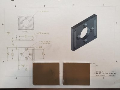

So after practising with the mill and CNC to make a stepper motor encoder holder back plate I thought it was time to get back to the robot arm.
Used the band saw to rough out two pieces of surplus material. Then square off and size the blanks to fit the drawing dimensions.

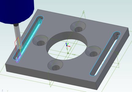

The next step is to use the CNC from the drawing to create the slots and holes.
After that I guess I'd better order the screws so I can mount the stepper motors to them.

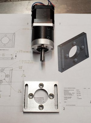

First screw up. Totally expecting that the hole wouldn't be round but hoping that the backlash compensation would fix that.
Mistake #1. Using conventional milling instead of climb milling. Bad surface finish.
Mistake #2. Way too fast a feed for spindle RPM even though I was way under the recommended values for the 1/8" mill.
On the second slot I think it pulled against the backlash again and snapped the cutter. The first slot was not straight for the same reason.
Cut back on speed to 5 IPM and 2850 RPM. Max depth of cut 0.050" and switched to climb milling. Much nicer finish and the slot stayed straighter.
The hole in the photo looks more oval than it really is because of the cell phone camera angle.
For the next one I'll use slower speeds and climb milling and pull out the boring head to bore the 25mm hole.
Alternatively put it in the 4 jaw chuck on the lathe and bore it to 25mm and close fit to the motor. Then onto the mill and center on this hole and finish doing the other holes and slots.
