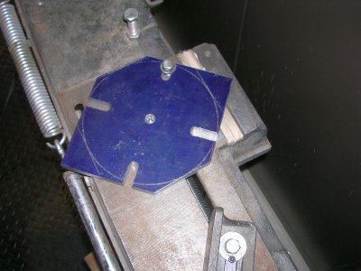

I'd cut off the corners in the bandsaw first and finish on the rotary table.
Cutting the corners off on a 6" square on a 4X6 bandsaw isn't as easy as it sounds....
I had to remove the vise fixed jaw and hold her down with a single bolt. Godda come up with some sort of clamping arrangement for this kind of stuff?

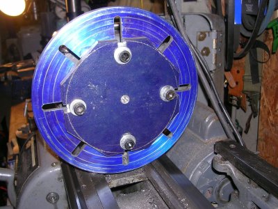

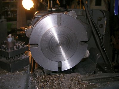

I've decided to try turning it round on the lathe. If that doesn't go well I'll try the RT.
Well that didn't take long at all.....
50 RPM, HSS tool. Sounded like a drum solo at first but soon settled down to a steady rhythm. Knew I was close when the swarf started coming off in curls. I'd call this a success:)
Now I'm hoping my 4J will hold it so that I can face if off and turn the chuck registration.
There's probably lots of different ways to do this job depending on the end result, but another idea is pre drill & tap some holes where the slots will eventually occur. That way you can use standoffs between the face plate & blank with bolts in from behind for the rounding operation as you've done, but also have a means to accurately face each side without having the bolt heads in the way. However you go about this, try & take off equal amounts. Not sure what material you have, but check for stress relief after skimming.

@PeterT I considered drilling and taping but got frustrated with the mill vise mounting issues and just decided to slot it and be done with it while it was still square rather than having to come back to it when it was round.

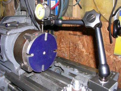

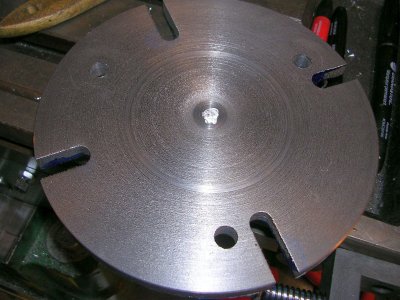

Faced off and chuck registration added.....
How the hell did I mess up the lengths of the slots that bad:oops:
Nailed the chuck registration:p She'll go on, but it's gonna be tight.

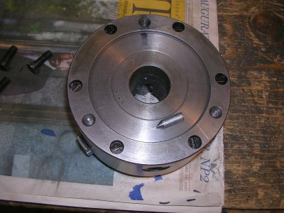

Nailed the chuck mounting holes..... Hey I'm getting better at this stuff:p
Used the pointy bullet in the blind mounting holes technique @RobinHood suggested (Thanks Rudy) when I mounted my Bison chuck.
Thought for sure the mounting bolts were M8 but they turned out to be 5/16-18. Have to source some 5/16 V Head screws now?

For cutting pieces too big for the vice I clamp a piece of 2x4 in the vice and then clamp the workpiece to that. You need t clamp really well, bolt it down or brace it against the vice jaw so it won’t move.

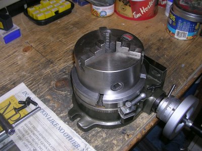

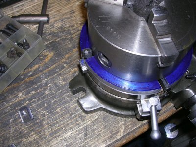

Oooops.... This ain't going to work very well:oops:
T-Nuts are going to run into the table locks. I think there is enough room to squeak them by once they are shortened on one side....
What size chuck is appropriate for a 6" RT?
I have the same problem..... I'm using threaded 'nuts' which removed some of the bulk, but its still clumsy. and just when I think I have it under control, the nut will catch the table locks.
so it would appear a smaller chuck or a smarter way of attaching it is required. I'm watching your progress so I can mimic your solution.
Hey Craig, nice project well done. What if you made new "T" nuts with the threaded hole on the outer end sufficient to clear the table locks. Perhaps there's enough room to drill and tap the "T" nuts you have hopefully they are not hardened. Nipping off the "T" nuts to clear your table locks should work. Just saying!
Just have a quick check of potential intersection points as the table turns

The bolts go through the face of the chuck into the backplate like this. The bolts would screw into the T
nuts on the rotary table.
Not following? What's a face bolt?

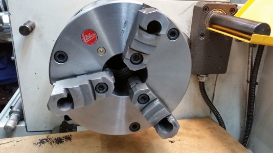

While we are more-or-less on the topic of back plates registrations I'm going to ask this question here. I need to turn a face plate for my new collet chuck, however I'm unsure I'm using the correct technical wording. So my spindle has a (positive registration protrusion) which means that side of my back plate requires a (negative registration). My collet chuck has a (negative registration) which means that side will require a (positive registration). Searched on google and can't come up with the correct official technical terms.
Would some kind member step in here and put me out of my correct term confusion.

Your terminology works for me:p Can you not modify the collet chuck to match your spindle and not bother with a mounting plate? What size is the chuck you have that mounts directly on the spindle?
There are probably a few interchangeable words for this. 'Boss' is often used to mean any kind of protruding feature. I see it used often in CAD circles for this kind of thing & a few chuck/backplate references. Sometimes it doesn't have a name, just a numerical dimension. 'Recess' or 'pocket' might be a good word for the negative mating surface.
