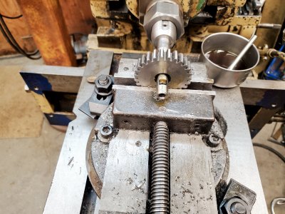

Well.... I think I can call my gear making venture a success...
Fits and functions just as well as the original.
Cutting the keyway into it turned into a bit of an adventure... On my first attempt to make a tool holder for the shaper I broke a 1/8" endmill trying to cut a tool slot in 1/2" round. There after I lost track of depth of cut and cut the slot too deep (top item). On the second attempt I made it all the way to tapping the hole for securing the cutting tool in the holder when I discovered I hadn't drilled the hole deep enough to allow the tap to cut full size thread. My attempt to use a bottom tap didn't go well at all (bottom item).
So then I decided to make a sleeve to hold my 3/8" boring bar. That worked to a point. First off I ground the cutting tool just a tad too narrow and secondly a 3/8" bar with a protruding cutting tool is a really tight fit in a 1/2" bore. Setting up was a PITA. In the end it did cut enough of a keyway (too narrow and too shallow) for me finish off with a needle file.
So, now I'm confident I can make usable gears with my little mill which was the purpose of this exercise in the first place.
I do how ever plan to post a critique of the RT dividing plate kit I got from Amazon as it was not usable out of the box.

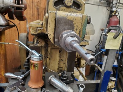

This is what I came up with for my shaper.
