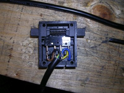

Can you pop the cover off and swap the switch locations?

Can you just swap the wires and leave the switches in place? It might save you some grief trying to put everything back together.
It's tight in there. You would have to remove the switches to disconnect and swap the wires so it was just easier to swap the switches around.

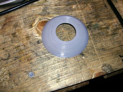

Looks like I need to relieve the hole a little. How does it attach to the power feed?
Mine just slips over and is held by friction.
Don't over-relieve the hole...

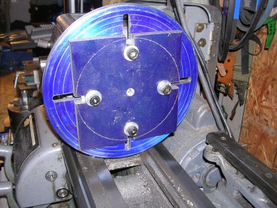

I acquired a 6" HV Rotary Table, nothing special, just your plain jane BB RT. Ordered indexing plates on Amazon that were delivered within a week from India. The plates fit ok, but had to make up a mounting collar for the plates in order to get the crank handle to work acceptably. Since I have a 5" 3J chuck sitting on the shelf under my lathe doing nothing, I decided to make an adapter plate....

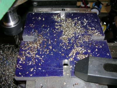

Starting with 6" X 6" X 1/2" plate.

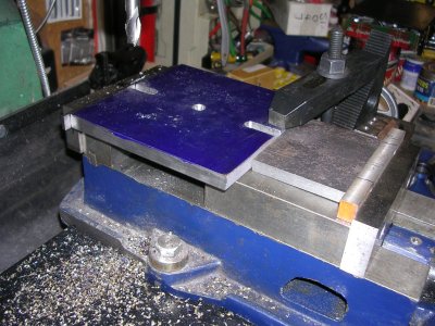

The setup on my mill turned out to be a bit of a challenge. I decided to drill a centering hole and mill mounting slots in one go.
Finally, with 4 slots, but not after having the plate move in the vise once @@@#$%$%&*(()()
Here it is mounted on my face plate (Thanks @Brent H ). Initial thoughts were to turn her round on the lathe, but milling it round on the RT is another option.
Suggestions? Lathe or RT?

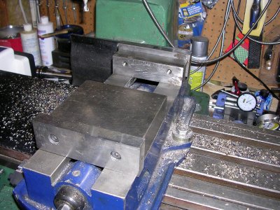

Craig, I'm curious, did those elevated vise jaws that allow you to use the full size of the vise slide with spacers involved come factory with the vise or was it a personal addition....if personal, very well done. I would have never thought of doing that until I seen it here and many times I needed "just a little more jaw opening" to grab something.
I'm with john...cut the corners off first bandsaw, cut-off saw or third choice, torch. Actually torch is quite viable, just bench grind the hardened outside edge a bit with bench grinder to ease pressure on lathe or mill cutter.
I think it's a factory feature. @Dabbler can you comment?
The jaws are secured with recessed hex cap screws that allow the jaws to be moved to the outside of the fixed and moving portions of the vise.
Normally I use it in this configuration with the jaws on the inside.
