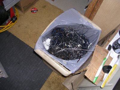

And lots of swarf in the process.

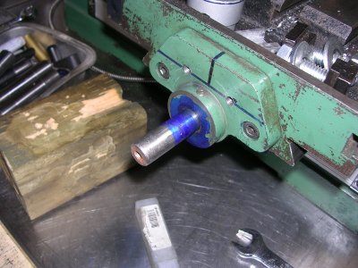

The PF is to be mounted on the LH side of mill on this lead screw bracket. The boss will be the registration and note the gitz oiler. In this image I have already drilled and tapped the mounting holes in the lead screw bracket.

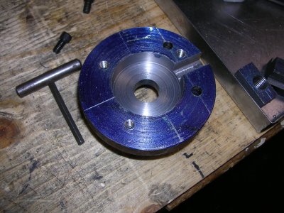

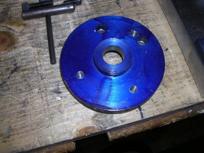

This is the mounting plate. 3-1/2" round stock with registration recess. The rectangular slot gives me access to the gitz oiler. In this image the PF and mill mounting holes have all been drilled and tapped.

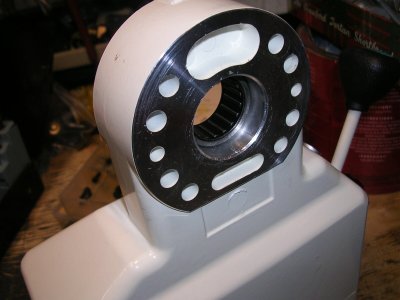

This is the mill side of the PF. Note the registration recess.
This is the PF side of the mounting plate with registration boss.

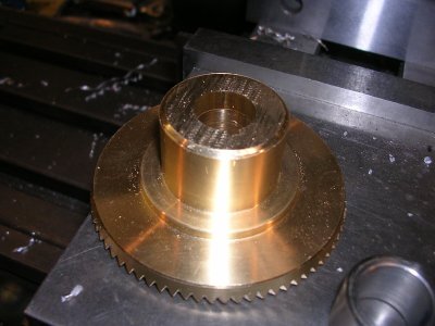

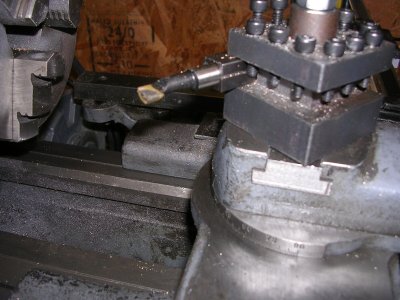

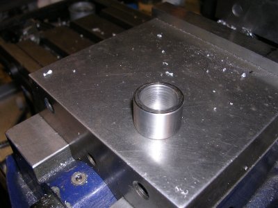

I had to make a bushing for the interface between the PF roller bearing and the lead screw. The one provided wasn't any where near the right size.
I used a milling head tool mounted in a boring bar holder to perform the bushing and drive gear boring. It worked pretty good.
This is the drive gear shortened and bored out 5/8" to 17mm.

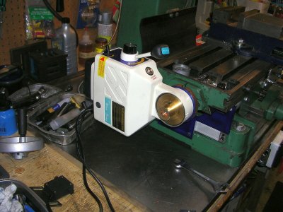

Here she is all mounted up. I used 1/4-20 SHCS to mount everything. All seems to work fine although as @David_R8 mentioned it is kind of noisy. Also it does make cranking by hand a little heavier. That might get better with time.

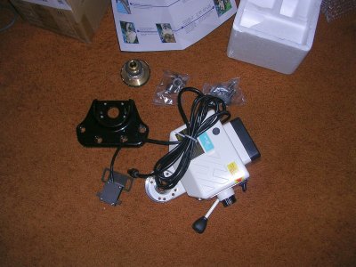

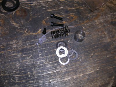

This is some stuff that was supplied. The bushing is the one I had to replace. Haven't a clue what the springs are for or how the shims are to be used. The instructions don't mention them at all.

You definitely got an X-axis unit as the orientation of the lever is completely different from mine. Is it left to move the table left or is it reversed?
Looks good!

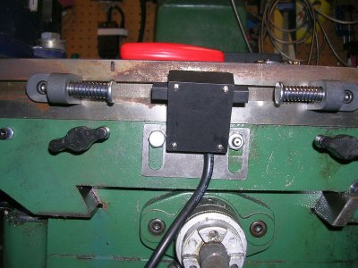

You're right, your lever is 90 deg but it's labeled the same way. I'm betting you can position that as you wish some how. As for which way is left and which way is right I didn't pay attention. I'll report back once I have flats on the lead screw for the gear sets screws to land on. Can you post an image of how you mounted the limit switch please.
You caught me out as I haven't installed the limit switches yet.:oops:
Ya, ok. does the mounting plate have a distinct bend to it?
As for lever and feed direction. Left is left and right is right. What does yours do?
Yes it does have a bend.
For me, toward me is right, away from me is left.
This video shows the springs at about 6:15ish
This ones explains the shims at about 5:00 ish

Ok now I understand when the mounting bracket is bent.
That's not your machine is it? I'm thinking a new limit switch mounting plate is in order.
As for the F/N/R lever orientation goes, there looks to be a screw holding the speed adjustment knob on and a set screw holding the direction lever on. I'm betting you can change the lever orientation if you want.

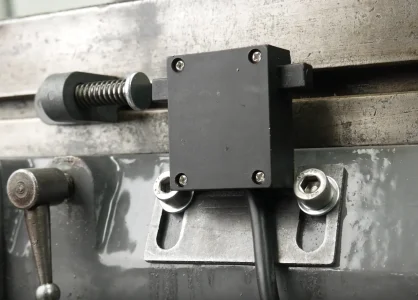

I compromised and mounted the Limit SW a little off center.
I drilled and tapped one new mounting hole. I need to keep one of the original mounting hole accessible as it serves as a table lubrication port.
NOW having done this...… I would appear the switch triggers backwards:oops: To kill motion to the right you have to press the button on the right.:confused:
How does yours behave?
