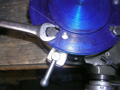

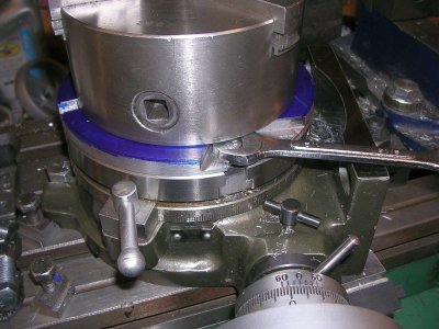

If one was to mill a step such that a hex head bolt would fit under the chuck, shaped as I have marked out here, the T-Nuts can be moved in board and the bolts tightened with a wrench. What do you think?
That could work. You’ll need to check that the modification of the chuck does not interfere with the fasteners which hold the two halves together or the pinions or the scroll itself.
Not messing with the chuck, I would mod the mounting plate.
Ah, ok. So you’d basically countersink the hex bolt deep enough so when tight, the head is below the surface of the plate. Plus you’d mill away enough material to get your spanner on to tighten the bolt. You could always reduce the bolt head height a bit too - and the thickness of the spanner to match.

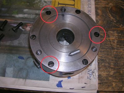

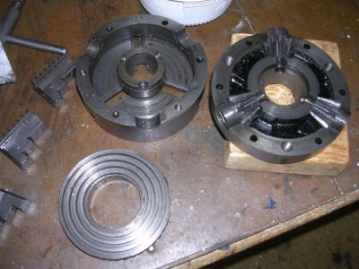

Have you had this chuck apart? Reason for asking: would there be enough material in the sidewall that you could make the red circled holes through holes and use 3 long bolts all the way through into the T-nut in the RT slot?

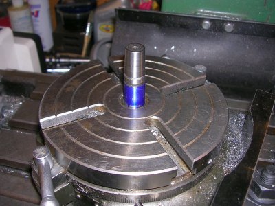

Another question: does your RT have a center hole? If so, you could make a pin to fit into that hole and also machine a matching hole into the mounting plate. That would transfer any radial loads from the chuck (through the register on the plate) to the pin and directly into the RT. You could then reduce the fastener size you use to hold the plate/chuck combo onto the RT. Might give you some more options as well.
Hmmmmm, it's a 4 slot RT, not 3.
What about using countersunk socket headscrews and V grove the slots so the screw head is just below the level of the chuck. That way you could start the screw in the t-nut and slide it right up to where the hex key meets the chuck then when the chuck is centered tighten down the screws.

Well.... this might just work....
There isn't much meat left at the bottom of the recess, but with 4 of them I think it should be ok. A thinner bolt head, a washer and a thinner spanner would help.
Now that I see the chuck apart, I'd be tempted to find a spacing that doesn't intersect jaw or key pinion, drill 4 holes through both lip sides & bolt directly through chuck into RT tee slots. No more middle man plate. That's probably how some of those front mount chucks work.

@PeterT Most RTs have a bored centre (cylindrical or MTx). RTs that have a manufacturer's 3J chuck usually have a registration boss on the back of the chuck for mounting the chuck concentric to the rotation. Does yours have this featiure?
@Dabbler, yes my RT has a MT taper in the center & the chucks typically have a recess to mate to a backplate boss. That recess theoretically makes the chuck body concentric to its male counterpart because (at least we hope) the recess was machined first, the jaws then inserted & ground. So good chucks will be close. I'm just saying in reality, the jaws & scroll have their final say in how concentric the part itself will be independent of the recess. I've also seen chucks with MT arbors on the back, but I'm not clear if the have any means to stay put rotationally other than friction.
What I've done, only because I have the doo-dad, is leave the chuck/plate snug but slightly loose on the RT table. Drop an MT test bar into the RT hole (MT on one end, cylindrical on the other) very lightly clamp the jaws on the bar & then secure the plate+chuck in this position. Release the test bar & ready for action. Even this is isn't bulletproof because the jaws are only registering on this particular bar diameter & may be different on another diameter (I think scroll accuracy?). And this may not lend itself to reversed jaws (mouth open) depending on the chuck.
Another homebrew system I've seen is the plate has a circular recess for the chuck OD plus some adjustment allowance & 4 radial set screws that act as a 'Set-Tru' principle. But it still required axial bolts through the chuck body into RT tee slots to retain the chuck axially. And the side loads are concentrated on the small area of set screws vs the boss/recess. For that effort maybe consider dedicating a chuck to the RT but I think the fellow wanted to do turning in the lathe, pop the chuck off with part still in & onto RT to preserve concentricity.
It's all this fiddle farting that makes me think its viable to mount a 4 jaw roughly concentric by eyeball & spend your time dialing in the part itself. But it all depends on the job. If you aren't thou chasing then do what is easiest. Also don't gronk on the test bar obviously, its hardened but bite marks would be a bad thing.

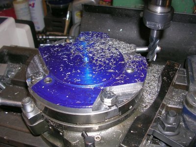

More progress today....
I'm loving that carbide end mill, it just goes and goes..... This was all side milling 1/4" DOC, wasn't even paying attention to side DOC, just make a pass and bump her over. All mill to the line stuff.
Weird eh... No where near symmetrical....🙄

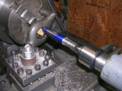

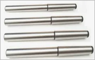

I'm thinking about turning this drill chuck 2MT arbor round to use as a RT centering jig. Do you think that will work or is it too hard?
Ends up you can turn a hardened and ground 2MT taper down.
The very end is hard but further back not so much. Tool needs sharpening now LOL.

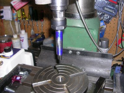

Centering the table to the RT with the 2MT taper....

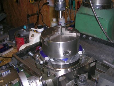

I assume this is a legit way to center the chuck on the centered RT. With the mounting plate loose, I clamped the jaws onto a 3/8" tool shank and then tightened down the plate hold down bolts.
@kevin.decelles this arrangement does tuck the T-Nuts in sufficiently.

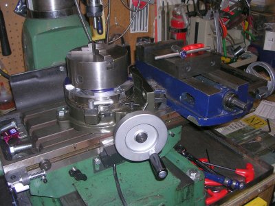

At @Dabbler 's suggestion I scooched the vise over in order to mount the RT but I'm having my doubts about this arrangement. Leaving the chuck attached to the RT is definitely a no-go. As well, the left hand side of the table has limited in board travel due to the power feed. Hmmmmm..... Maybe a little to crowded I think.
The idea is to skootch your vise over 4-5" off centre. This gives you the *opportunity* to mount the RT without moving your vise away (most of the time). No one leaves their RT on their mill full time. It's just in the way.
This is fine for most small work. Once the job gets bigger, you need the RT in the centre of the table anyway, so the vise has to go.
