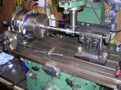

So, now that I have a 6" HV RT I want to try some gear cutting. I sourced some indexing plates from Amazon that shipped from India, a set of DP 16 PA 14.5 cutters with R8 arbor from Amazon and a Grizzly tail stock from @140mower (Thanks Don).

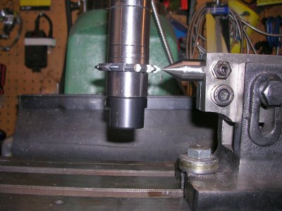

First go will be a 14T 1" Dia gear made from aluminum. This is my setup. I'm a little perplexed as to how to set the cutter height?
Do you think this is close enough?
Touch off on the flat of the cutter then lower by 1/2 cutter dia & work dia or you could use the ruler thing between the workpiece and cutter.

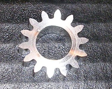

Well..... It looks like a gear, smells like a gear, has 14 teeth........:p
I think the teeth are a little too deep.
I used this website to calculate the tooth depth.

Meshes OK with what I was trying to replicate.

@YYCHM : Whole Depth (Preferred) ht = 2.250 ÷ P so for 16DP your cutter depth is 0.141"
0.14 is what I dialed in. Why does this gear have such a narrow flat on the top of each tooth (0.03)? Doesn't look like the one I was trying to replicate (0.06).

@YYCHM : You have to remember that the simple spur gear cutters arranged in the 8 tooth profile all cut a variety of # of teeth. So the cutter will only be "somewhat" accurate over the range of teeth it can produce. Using a hob will allow the teeth to be cut with a more accurate profile over the whole span of tooth number due to its design, cutter angle etc.
Also check the depth of the tooth profile in the one you are trying to copy. It may be that the manufacturer cut slightly shallower tooth to match something in the product. You can mess around with the back lash in this way.

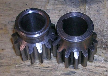

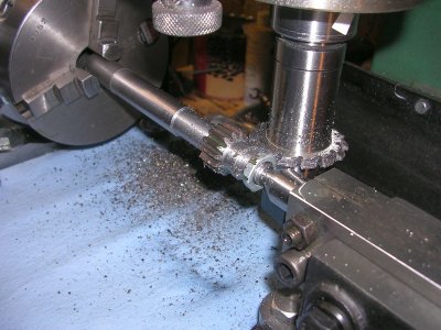

Today I tried cutting the same gear in mild steel......
I setup ala @RobinHood style and spritzed it with cutting fluid ever pass.
200 RPM which is 20 HZ on the VFD. I was really surprised and pleased that my mill would cut a full depth tooth 0.13 in one pass without complaining.

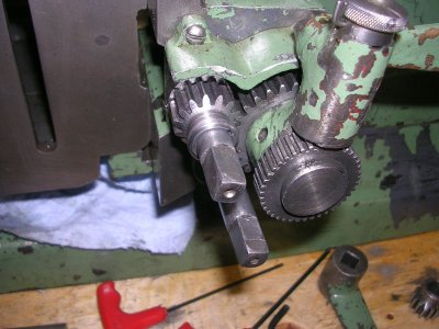

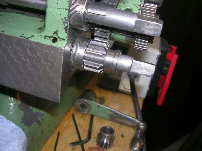

I'm trying to replicate a feed drive gear that's on my shaper. The original gear is on the right.
Wish I had a wire wheel to knock all the burrs off the cut gear:( Still need to cut the key way. Will need to rig something up on the shaper and that will be this afternoons project.
Nice results! So how are you feeding, like conventional mill one way & climb cut back out. Or no climb at all or...? What about depth, full pass or 80/20 or?

Not sure what you mean by climb cut back out? I fed the blank into the cutter and then backed up and positioned the bank for the next tooth. First tooth I cut to depth in two 50/50 stages. That went well so I tried full depth on the second tooth and that was ok as well, so every tooth there after was cut full depth in one pass.

That was probably a good decision to go that big. I used 1.5hp and wonder if it would have enough grunt to do the same as you did at 20hz.
Seems to work well at low HZ. I've done lots of 20-30 HZ 1/2"-1" drilling with it. Also, 2" face milling and fly cutting 2+". The original single phase motor was 2HP and I was really tempted to up that with the 3 phase motor, but so far so good.
Also, I think my VFD is one of those torque compensating units and 3HP.

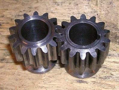

Well.... I think I can call my gear making venture a success...
Fits and functions just as well as the original.

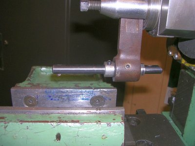

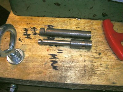

Cutting the keyway into it turned into a bit of an adventure... On my first attempt to make a tool holder for the shaper I broke a 1/8" endmill trying to cut a tool slot in 1/2" round. There after I lost track of depth of cut and cut the slot too deep (top item). On the second attempt I made it all the way to tapping the hole for securing the cutting tool in the holder when I discovered I hadn't drilled the hole deep enough to allow the tap to cut full size thread. My attempt to use a bottom tap didn't go well at all (bottom item).
So then I decided to make a sleeve to hold my 3/8" boring bar. That worked to a point. First off I ground the cutting tool just a tad too narrow and secondly a 3/8" bar with a protruding cutting tool is a really tight fit in a 1/2" bore. Setting up was a PITA. In the end it did cut enough of a keyway (too narrow and too shallow) for me finish off with a needle file.
