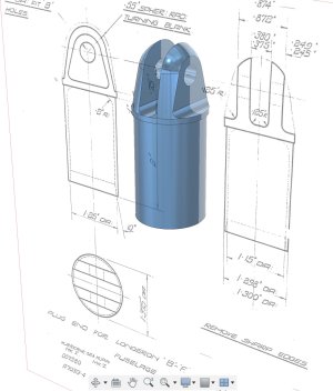

I‘m modelling some parts for a friend who sends them off to be 3D printed before he gets them CNC machined.
I have a couple of questions about the printing (slicer?) software thats used:
- Can you change the orientation of the model within the printing software, or does the model have to be made in the best orientation for printing?
- Does the printing software automatically generate the necessary supports for things like undercuts, or are they manually added?
I like to do expansion and orientation in the CAD software. I am sure the printer software will compensate, but its better to control it yourself.
Something to keep in mind when using a 3D printer. It doesn't all have to be printed in one go. If you can, you are best off to visualize the nicest way to print it for max strength etc. and then create the parts separately. Krazy glue or even hotmelt or 5 minute epoxy can take care of reconstructing the model.

I’m surprised that the printers software doesn’t “automatically” compensate for contraction of the different types of filament, or that it’s better to do this in the CAD software.
For a part like this, would the bottom or the top (with supports) be best for being up against the printer bed:
I have my guess, but since I don’t own a 3D printer I’m interested if my guess is correct.

Too many variables. Although I've seen some very beautiful 3D prints IMHO, it's still cheap plastic molding. And I use it all the time. But it's not even close to a part made with injection molded plastic. And there they design the mold so that shrinkage creates the correctly sized part.

I wouldn't print this as a vertical part. Each layer is a weak point. There's no strength there. Think about splitting firewood. It won't split across the growth rings. You have to saw it into short pieces. Then split along the grain. The 3D printing has the same strength issues but opposite to a tree trunk.

Is the 3D printed part functional? or is it a visual, o to check fit? If only for looks, non stress testing, then this would be the most efficient way to print it. If the holes that go sideways take any stress, it will crack for sure, and so laying it sideways in two parts like @jcdammeyer says is the best way. Add some locators to the two halfs, protrusions-one half, pocket the other and glue.

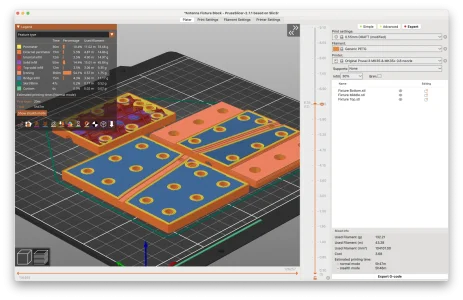

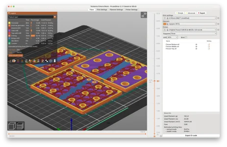

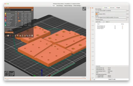

I prefer native CAD, or X_T , STP. I can convert from just about any format with fusion if my CAD doesn't support it. I prefer to triangulate the model myself, as the free STL's are usually jaggedly. I convert the STL's with a 0.0001 tolerance and 1 degree on the angle, resulting in large STL, but very smooth product.
The slicers keep getting better. You could specify a lot of perimeters and a dense infill for the top 1/3 of the part and leave the bottom 2/3 with weaker settings.
Just to get an idea. Below is slicer screen shots at different depths through the part. You can see the internal structure. This is with a 30% infill and 3 layers around the outside of the part (3 perimeters). All these details are controllable.
