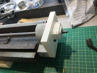

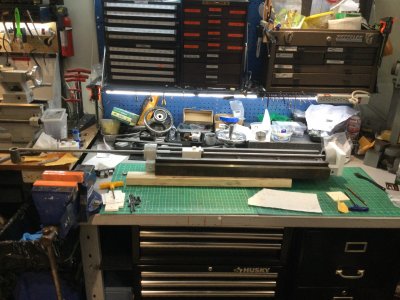

I'm finding printing 3D parts for test fit before even starting up the mill is actually saving me considerable time and raising confidence that what I finally make on the mill is going to be just right. Printing time can be long for big parts, but if you start it before bedtime it's waiting for you in the morning.
Here is an example of a mounting plate for new ballscrew that uses the original mounting holes. I grabbed the step file for the BK block integrated it into my end plate because the actual BK block won't arrive until Thursday.
Tonight I'm printing the other side BF with the floating bearing, seems like there is a step file available for everything nowadays, was not the case even 10-15 years ago. Makes throwing together a model really quick and easy.
My buddy gave me the extra long ballscrew, I need to shorten it.
