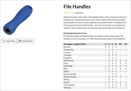

Meant to add, he blue bodies have a cross index of types/sizes of files which fit their threads

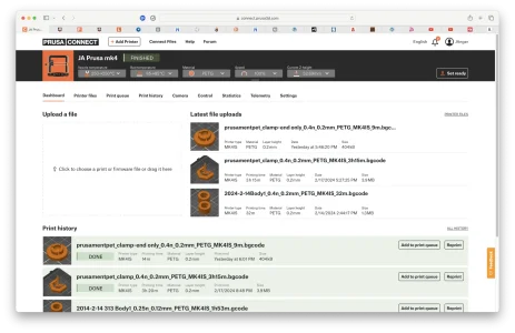

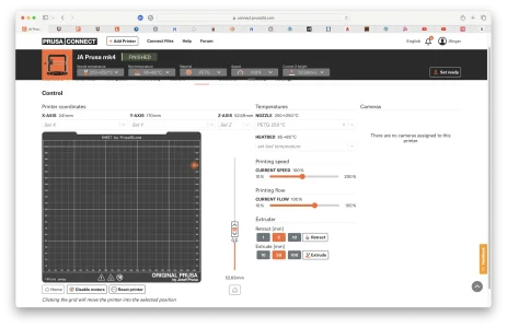

I discovered Prusa Connect - their cloud service to control your printer farm. Works well and is easier to use than Prusa Link which is the web app they have running on the printer itself. The only thing missing is tighter integration to the slicer software - still have to output a file and load it up in the control panel. And it needs a camera. But no more sneaker net at least.
