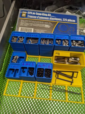

Gridfinity?
Gridfinity-rebuilt? It's a compatible OpenSCAD version found on github. I've modified it to print labels onto the tabs, though there remain some kinks to work out.
I have my own version I started before I found this one. I might sink a few more hours into mine as the code quality/modifiability of this thing is pretty heinous.
I should add that I particularly like the small (42mm x 42mm x 21mm) buckets with one or two dividers to hold the 3-8mm set screws that otherwise scatter everywhere when you knock the princess auto tray the come in...
Those look really convenient, but also fragile. I'd be a bit afraid I'd knock them over with my big claws. Do they fit in some kind of tray holder to keep them secure or are they meant to be individually packed into a drawer?
If they are anything like the Gridfinity system they fit together quite securely. And when the grid is filled up they are even more secure.
Those look good PaulL, the biggest problem I have with the smaller bins is they are sometimes to deep, and I need needle nose or tweezers to get screws etc. out of them. I know, keep the bin full. That way you never drop the last and only one either.
The Gridfinity system also allows for small magnets in the bottom the bins to interface with the base grid. I use the system without the magnets for some of the shop drawers to keep everything from piling up at the back. I have had zero luck with the non slip mats.
You can see the grid tray in the bottom. The bins click into the grid, and nest in one-another the same way. They are quite secure.
I don't have a nice way to pick up the whole grid yet, but I will.
You can also make up lids quite easily.
Yeah. That's why I like the 2-3 "unit" heights. A gridfinity height unit is 7mm, so they can be quite shallow, comfortably.
To get parts out, there's a cylindrical scoop in the front so you don't get parts trapped in the corner.
You can customize the height of the gridfinity bins in the F360 addon. I think you can print them in multiple of 7 mm.
