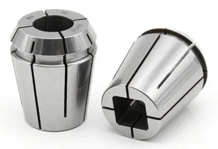

I think I've mentioned before that for power tapping I now have collets that have square registration holes at the back to keep them from turning. Bought through AliExpress.
Doesn't that turn into a complexity nightmare John?
Taps come in a wide variety of square drive sizes and shaft diameters. To fit all taps, even accounting for collet size accommodation, wouldn't you need 2 or 3 of each square drive size to fit the associated tap shaft sizes? And how does that handle the little ones like a #4 screw where the tap shank isn't long enough to reach the back of the collet?

The short answer is yes. The longer answer is yes. OK. The really long answer is it fits many taps but not all. Have to still do those manual or if they are small likely a standard collet will hold them anyway. The torque that would cause a 4-40 to slip would likely snap it in the hole and then you need to use EDM to remove the tap fragment.
