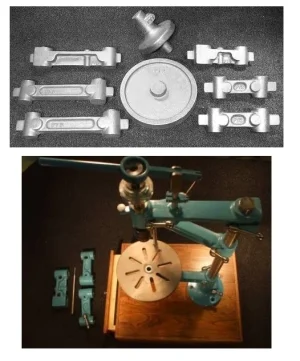

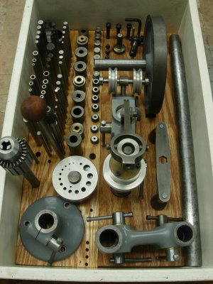

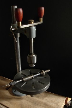

The UPT is a classic British home shop project by the venerable George Thomas. It's a drill press, number/letter stamp guide, staking tool and tapping guide with different accessories and uses. Great project and very useful ..... two of the tapping heads on mine shown below. I also included a shot of the overall kit, should give a sense of how it has many functions and can put together in several configurations.

I vote for the UPT as well, except mine lives permanetly on a workbench. It is used that often. Esp. the tapping arm. Also made an attachment for rebushing clock plates, that is in the last chapter of the book.

Don't have a Universal Pillar Tool, but have seen articles & ads for many years. The castings (and George Thomas's book which captured the build articles from The Model Engineer) are available from MartinModel:

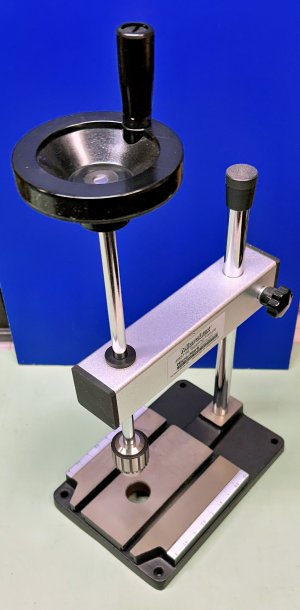

I do have a MicroMark/MicroLux Tapping Fixture (mine is the older, #83146 version, basically the same item):

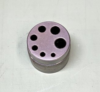

I also have a commercial version of the guide block described by @Mcgyver:

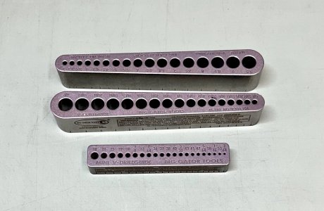

and a range of Big Gator V-DrllGuides® (these are just a sample, but but I don't have all of what are available:

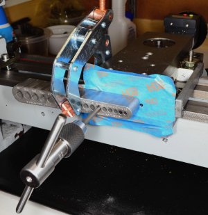

These are nice because of the V-groove on the back, but are sometimes a challenge to use on in-place Machine surfaces when drilling & tapping mounting holes:
I understand now. Never saw anything like that before. I can see now why your situation is so different. We have totally different tapping paradigms.
The vast majority of my work is on full size machines, and full size tools. Not models, clocks, and tiny things. My work is also often in the farm yard or out in a plowed field. How would I get a farm part onto that gizmo? Sometimes I can't even get the parts on my mill!
For my needs, a drill press, or a mill, or a lathe, are the best platforms to tap things IF I can swing it. I can only wish they could be used out in a plowed field on a 3000lb plow frame too.
That UPT looks like an amazing little tool for its intended purpose, but prolly out of its element and not well suited to my needs. Not saying I'd never use it, just that it wouldn't be my goto tapping platform.

For sure, everyone's requirements are different. I only mentioned it in the context of the POS Tap guide or a way to guide taps with the 60 degree point on the end, i.e. no need for them with one and it is only used for small stuff. Large stuff gets power tapped in the mill or hand tapped with a guide (hunk of whatever material faced square with a bore to fit the tap). The latter is so simply and works so well, The UPT is for very tiny taps like 0-80 and/or when there many holes to tap

I have a few 1" thick blocks with various holes, and they seem to work fine and can be used almost anywhere when the thing being tapped can't be mounted on the mill. It works for me.
I have a guide block like that and an assortment of drill guides just like those.
I won't say that they don't work, but I will say that they usually don't work very well with my two hands and tools. You can clamp them and adjust them and get it to work, but I'm just not patient enough. I end up setting them aside and just Gettin it done.
Even for those times where they would be perfect, the mill or drill press is almost always better. The mere fact that I have them is a testament to how much I need their functionality, but sadly, they mostly gather dust in a drawer in my shop.

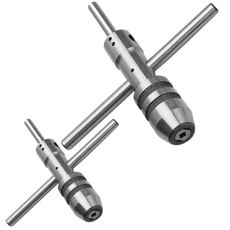

I've never had a tap follower, I bought a set of piloted spindle tappers early in my apprenticeship.
But, lacking power knee lift, I'm always looking for ways to reduce the required z clearance. I stumbled upon this idea,
which I like a lot when combined with 1/4 hex tap drivers.
Those look nice. Does the tap holder slide on the part that goes into the drill chuck? Is it spring driven? If so, the only downside is the short leverage on the handles. Presumably, that is easily fixed.
Yes, the shaft is just a dowel pin. No spring, the tap handle just floats on the shaft. All too often the shaft falls out between toolbox and machine and rolls under something. The same is true of the handles, I put some plastic caps on mine to keep them from sliding out.
A standard tap handle of this style could probably be modified like this.
