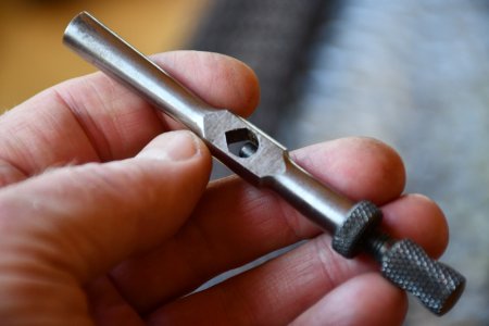

Starrett 174 Tap Wrench Arrived! It is so damn cute I could eat it! Again, Thanks Stel!

I have a small one as well, which works ok, doesn't have the "v" in the body or plunger.
The 174 has the body V, but not the plunger V that the rest of the family has. The plunger is just a flat ended screw that pushes on the corner of a tap head to jamb the opposite corner into the body V.
Here is another family photo which includes the new baby......
I'm really not as much of a tool collector as I am a user but looking at this set, I guess I really should see if I can find the big brother. They really are a superior tap wrench vs what else is out there.
At least my M&W holder has a V in both the body and the plunger. I've had it for decades but I'm unsure when it was made. Perhaps they have changed over the years.

If you can't find the Starrett #174 holder the Moore & Wright equivalent isn't bad.
Hey Ken, my hands are prolly bigger than yours but that M&W looks more the size of a Starrett 91A. The 174 is 3.5" long and the 91A is 5-1/2. Or maybe the M&W is someplace in between?
Regardless, the M&W does look like a quality Tap Wrench. It's hard to believe I have used the crap I had before for sooooo many years.
