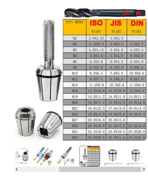

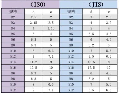

Handy tables to have.Here is another one with metric up to an inch.

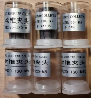

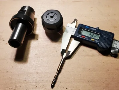

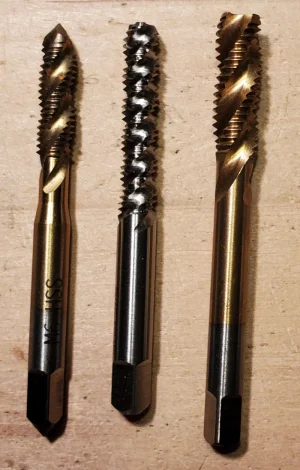

This chart actually makes more sense for the taps I have. Tempted to order one more of each M6, ISO and JIS. They are $12 each for the ER20.My experience with metric taps on Ali is they mostly have common ISO shanks & squares, but not always. Kind of depends if they are manufacturing for a name or if they are kind of freelancing. And as the table shows, ISO is different that JIS & I think there are even different ISO's when it comes to taps.

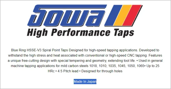

Lately I have been buying <cough> 'names' like YG or more recently Guling (phonetically similar to Guhring). Are they relabeled, contraband, clones? I have no idea. They seem decent quality & cut well. Personally I like SOWA branded taps available in Canada but I have to get them through a local distributer, which means a drive... so I usually revert to the offshores for convenience.
Ali
I like Sowa too. I often get them on Amazon and they do the driving for me. My local jobber carries Dormer but has to order the odd one. As good as the Dormers are, I think the Sowa are better.
It's enough to make one want to join the wife on the couch and grab a couple of needles and take up knitting.
Wow, high praise. afaik Sowa has always just been a distributor and their house brand is re-badged made in China stuff.

I have 3 of these ER 40 collets for imperial 1/4, 3/8, 1/2 inch drive no metric at all.I think I've mentioned before that for power tapping I now have collets that have square registration holes at the back to keep them from turning. Bought through AliExpress.
