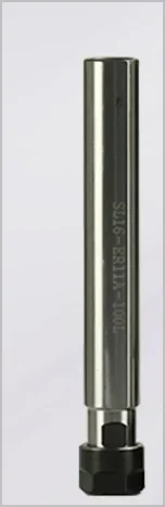

I've shown my tap holders before for small holes. The set screws contact the tap flats. With the chuck set up for the pilot drill, just insert the tool, often without raising the head. The chuck jaws are just a smidge loose on the tool shank so its being guided vertically but no resistance to rotation with the tommy bar. Or alternatively chuck the shank & power tap to certain safe depth & finish with the tommy bar. I find tap wrenches more of a stack-up PITA & not as axially aligned. Fine pitches require very little down force & the spring is non-linear, so again more of a PITA.
The downside is, tap shanks vary in diameter so I have a few sizes. I was just thinking the other day I could replace this with something like a small ER-11 collet shank. they are cheap on ALI

I was thinking this as well. In fact an ER16 would go from #0- 1/2" tap. You can get the short versions (4" overall length), cut a 60° center in the end, and you could manually tap with a spring loaded center or power tap.
