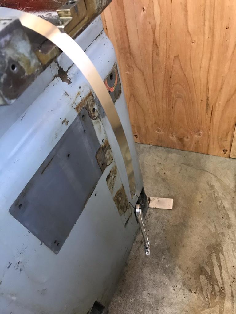

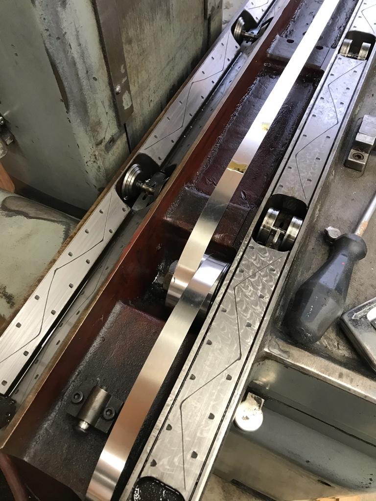

Bands are on!
The instructions from Parker Majestic say to fill the oil wells halfway so I’m waiting on a delivery of way oil from KBC before I reset the table.

It lives!
Undressed wheel because KBC is sold out of the diamond dresser I ordered.
But the table went back on just fine.
Table is silky smooth.
Definitely takes some coordination to grind smoothly though I can see it being a bit of a zen activity.
Precision objects, here we come! LOL
