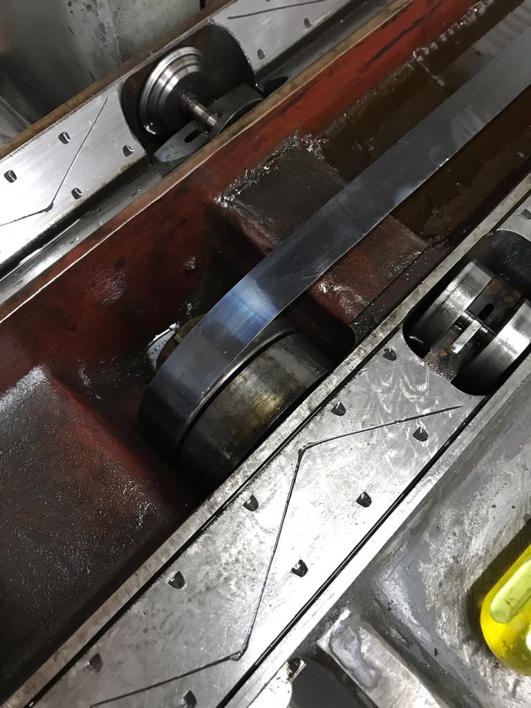

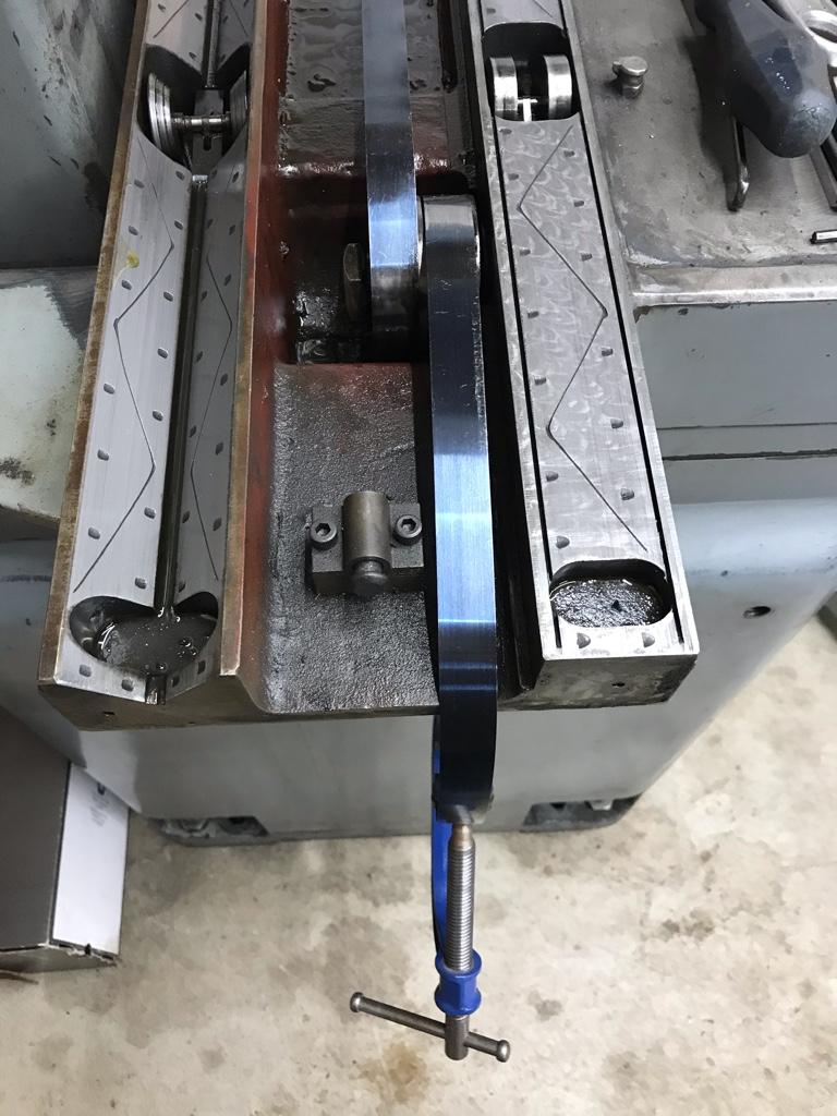

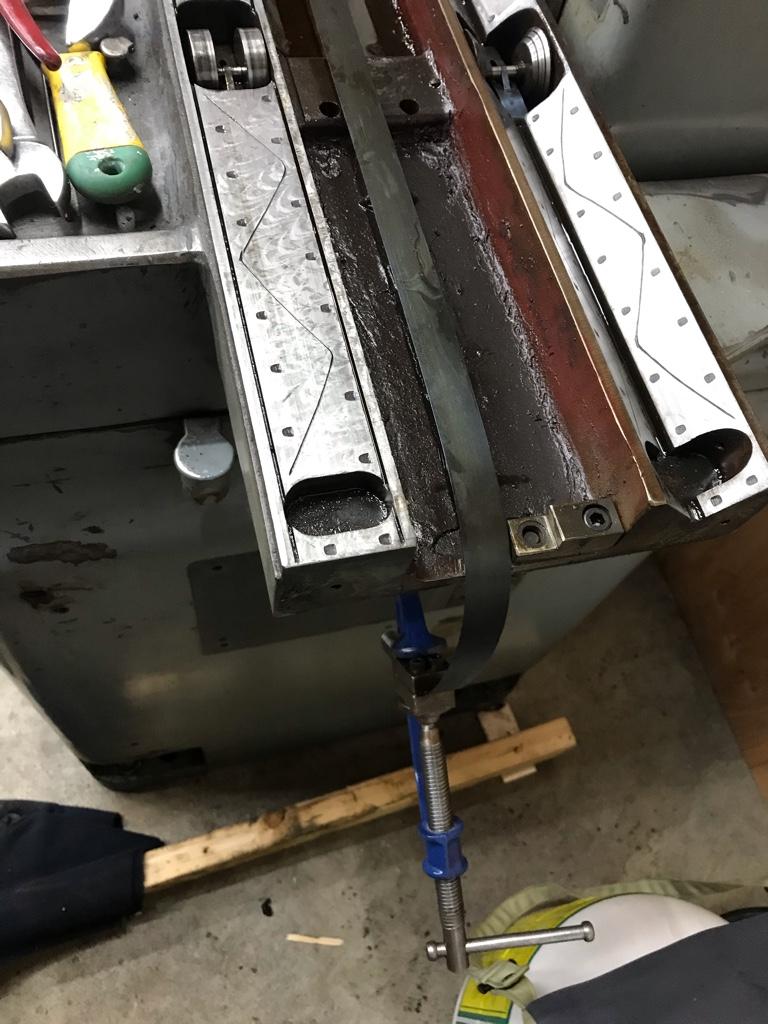

I had a few minutes this afternoon and so I completely removed the table so I could figure out how to approach the problem.
I installed the right side band and weighted the end with a C clamp so it wouldn’t unroll.
The I marked and drilled the left side band and installed it. It was absolutely easy to drill. I was about to roll it in when I realized that it had to be wound on by hand so that it was at the length it would be with the table centred. So I snaked it under the other band till it was the right length.
Attached another clamp to that end.
Here they are both installed.

@David_R8 : Is there enough tape to reconnect?
There was enough. I haven’t put the table back on yet so that will be the acid test to see if I get full travel. I suspect I will but time will tell.

I’ve been thinking about it for days, trying to figure out how to put it back together.
While it’s apart I’m going to paint the top of the cross slide and the table.
I can only think it will make it easier to keep clean with a coat or two of enamel.

Thanks, I discovered that the bands are actually not hardened spring steel. I was actually able to trim off the ragged, broken end using a pair of Klein 4" scissors. Drilling new holes was a bit of a trick because of the challenges of drilling thin material.
