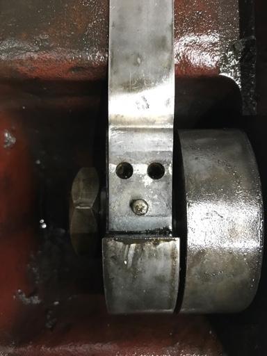

Seeing the links provided by others for constant force springs makes me think maybe the alloy / heat treat is important. The shim stock is stainless I believe but I didn't check much more.
Maybe with some searching you can find exactly what you need in proper width.
KBC has .010 shim stock in 25' rolls though it's only 1/2' wide. I think that could actually work as its secured on a pin and clamped really well at both ends
Does it have to coil like the Mcmaster link Brent included? If so I have a feeling shim stock might be hardened & too stiff? I think I have some .005" thick & its in a ~ 6x6" box with some tension. When you unwind a section it really wants to be flat.
Right now they don't coil, they are just laying out flat. It's actually a problem because they want to unwind from the hub leading to a big snarl when I'm trying to put it together. I spent a bunch of Friday afternoon wrestling with them.
Something that coiled around the hub would actually be helpful I think.
I just measured the straps. One is 34" long the other is 54" long.
The ends that attach to the table have never been wound around the hub and are completely flat. So that leads me to think that they start out flat.
It can also be bent somewhat easily unlike blue steel such as this
Either this shim stock on a roll or the SS strapping (thanks @RobinHood) are the closest matches I've seen so far.|
This strapping might also work.

I was awake at 0500 hrs today so was thinking that I'm going to try drilling new holes in the existing bands and see how that goes.
I also thought about using heavy clamps on the table ends of the bands to put tension on them so they don't unwind. On the right side I might add a bungee cord to the wall for additional tension and out to the drill press stand on the left.
Working alone, a guy's got to be creative!
Drilling holes in thin, semi hardened metal like that can be fun. I'd suggest a smaller size to start just in case you get the wonky oblong effect & have to dress it round with a Dremel stone. Sometimes those graduated step drills help.
What size hole is required? I have an Atkins #5 butcher’s saw punch that might work as well.
I haven’t measured it but I’d estimate it to be 3/16”?
That’s what it looked like to me as well. My punch will make a 0.175” hole, so just under 3/16” ( 0.1875 ). At least that is the size of the slug that comes out — I’ll see if the actual hole is a shade larger. I’m in the shop anyway.
Gosh that’s kind Frank.
Hmm, hole is 0.172” or 11/64”
I can’t get a #17 bit through and a #18 is slack, but an 11/64” is juuust right.
The pins are spot on 3/16”
Darn! Oh well, if you still wanted to use it to punch an undersize hole and open up from that, it’s here and I’d happily let you try it if you wanted. Otherwise I’ll leave you to your own devices :)
