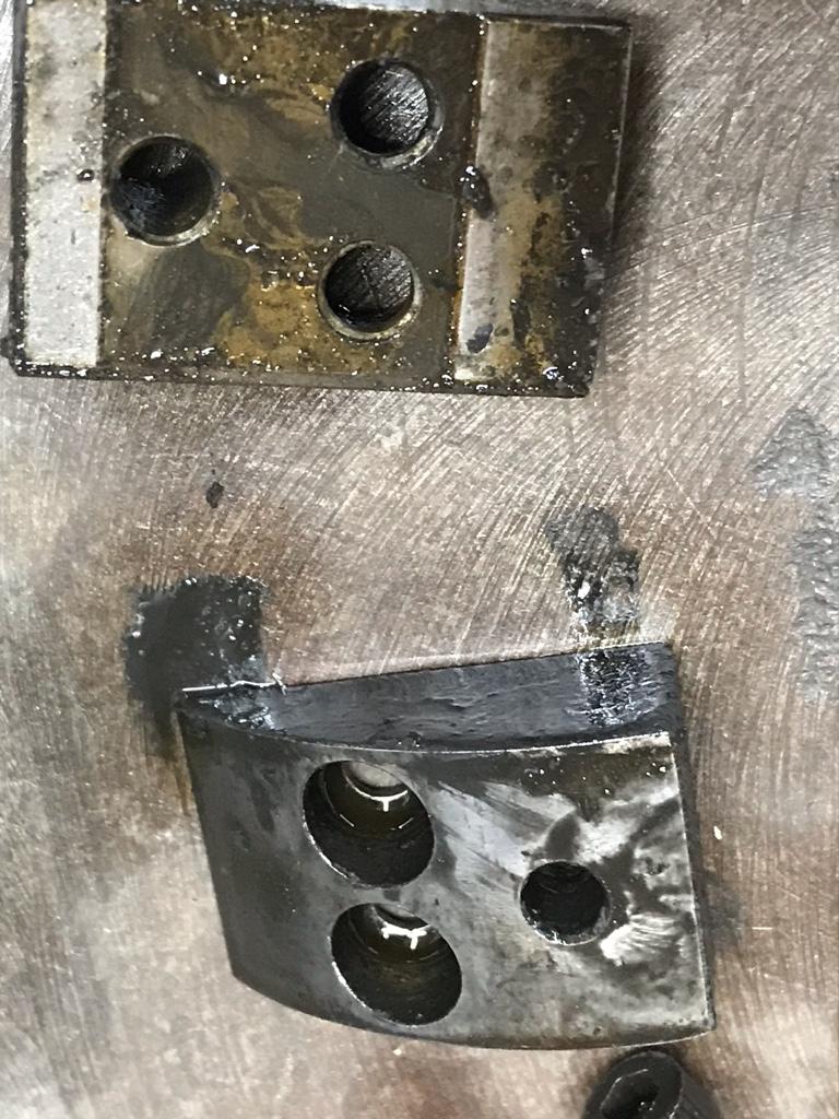

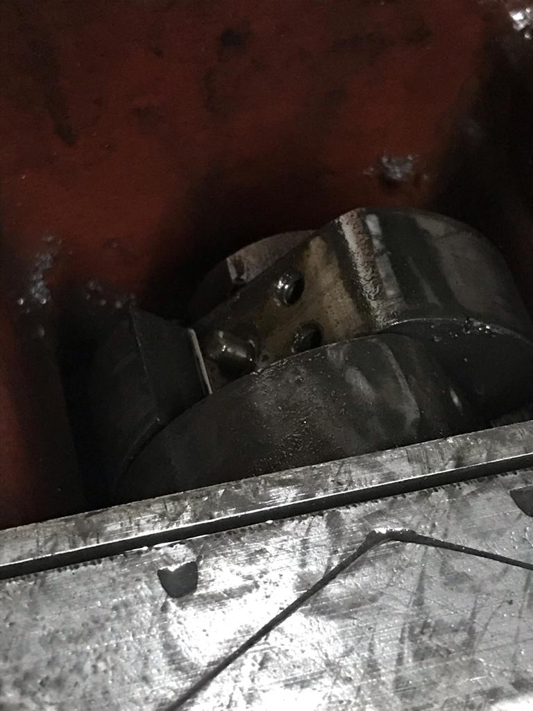

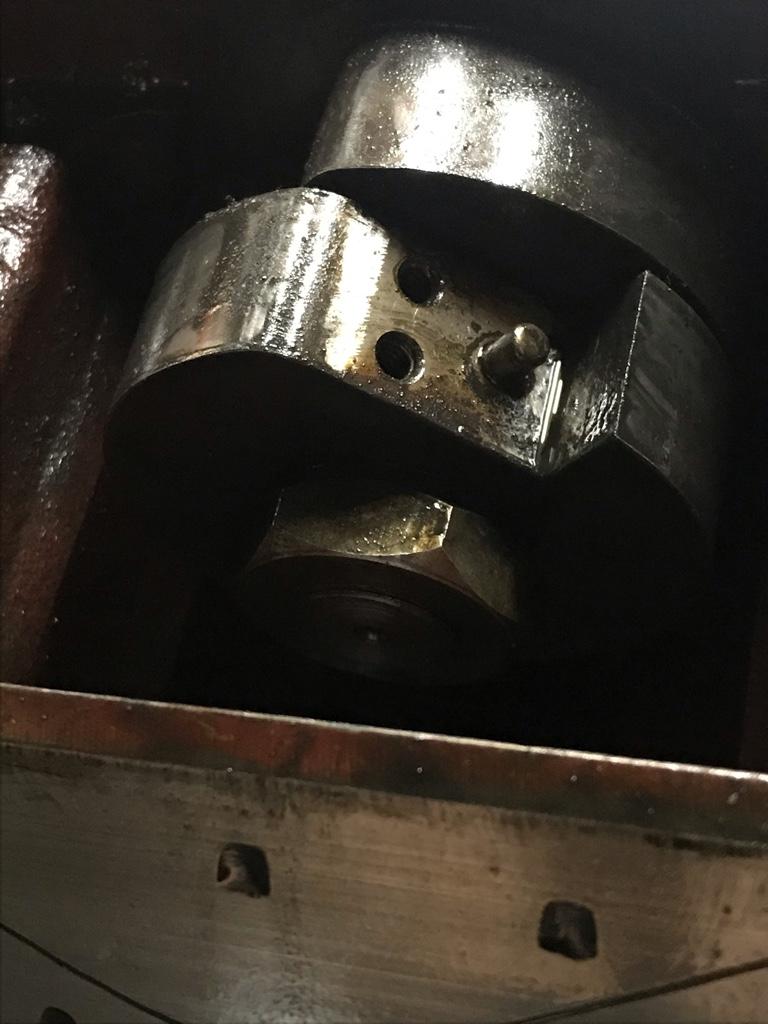

The rectangular block and the square drive thing are not original.
Underneath the square drive there is this round shaft and similar circular wear pattern which I suspect is from the original lever.
Is that what takes the roll pin you were trying to size?
Yup.
The hole in the round shaft is larger than the hole in the square drive thing so it kinda flops around because it’s not held securely. Plus it’s a loose fit on the shaft.
That is good detective work @David_R8. I bet it got sloppy over time and they improved it by adding the rectangular bushing bolted to the outside. I would agree with you that making a new, better fitting bushing and using a square drive will work just fine.
Surprisingly the fit of the shaft in the chuck housing is good, maybe a thousand or two of wiggle.
Whatever grease/oil that was put in there in 1963 has given up the ghost and is no long providing any lubrication.
I think when I clean and properly lubricate everything less force will be required to actuate the chuck.

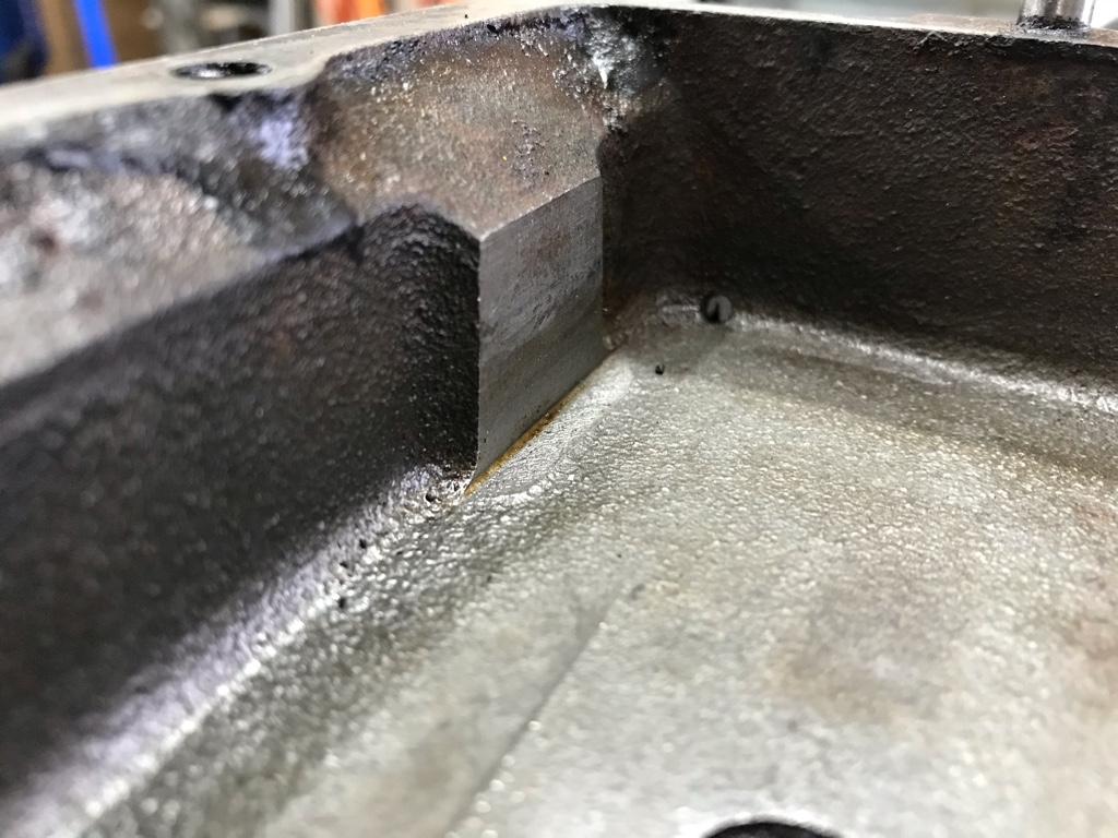

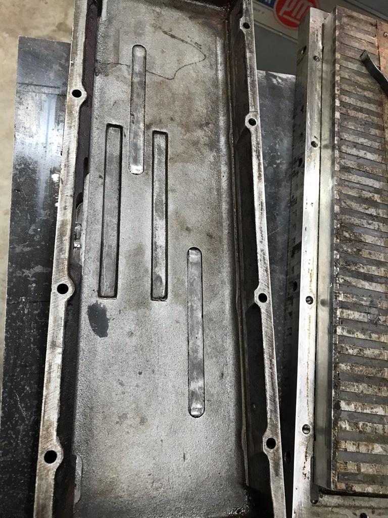

I reassembled the chuck this morning.
Cleaned out the dried grease.
I was all set to fill it with 90w oil as directed by the Walker rep when I spied a hole in a corner.
Wanting to follow their advice and put oil in the base, I enlarged the hole to take a 10-32 set screw. I dipped the set screw in Permatex and screwed it in snug.
Filled it with a quarter inch of 90w oil, applied more Permatex to the edge of the base and popped on the mag plates.
Other than the plates being about 30 lbs and very hard to hold, it was a dead easy job.

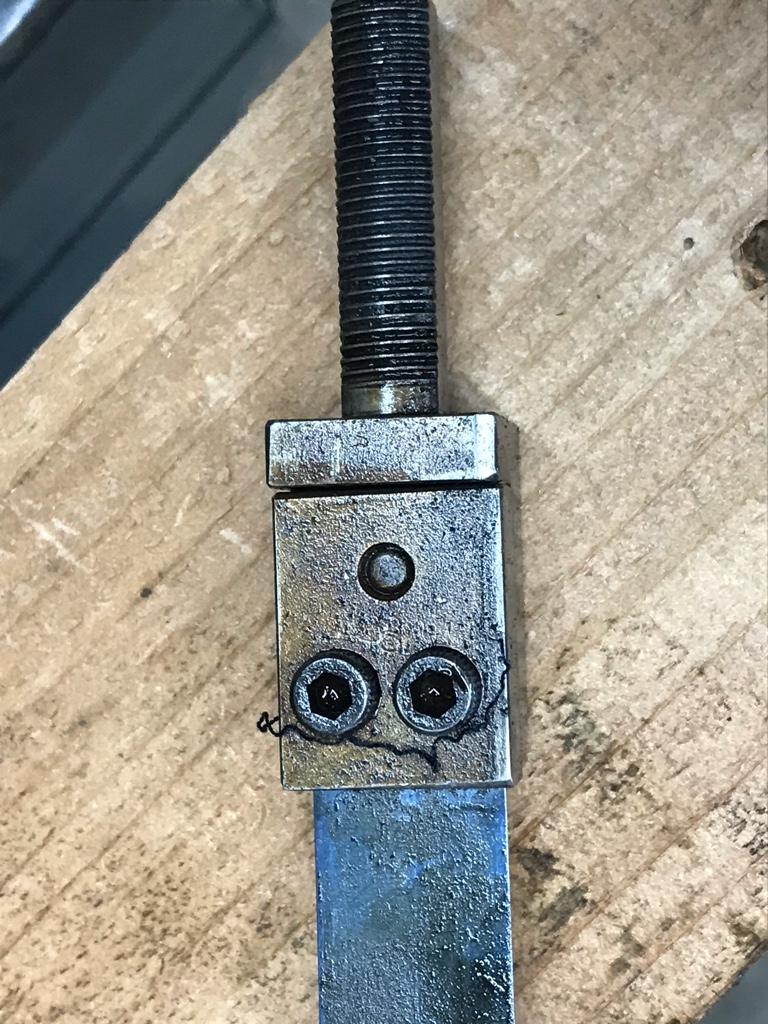

Here are some pics of the parts for the table drive.
This is the hub end of the band.
This is the end that attaches to the table.
This is the hub taken from the front of the machine.
The hub closest to the camera is for the left side of the table, the other is for the right side.
This is taken from the back of the machine.
These are the clamps that secure the band to the hub.
What is the trouble David? Need Drive tape? what size are you needing?
Yes the drives tapes are end of life.
The one for the left side of the table broke at the hub end and the other has a crack in the same location.
Thé band is .01” thick and .75” wide.
I can find .01” x .50” wide shim tape but not .75”.
I’m also considering turning a new hub amd using a cable as another Parker Majestic owner has done on two machines.
